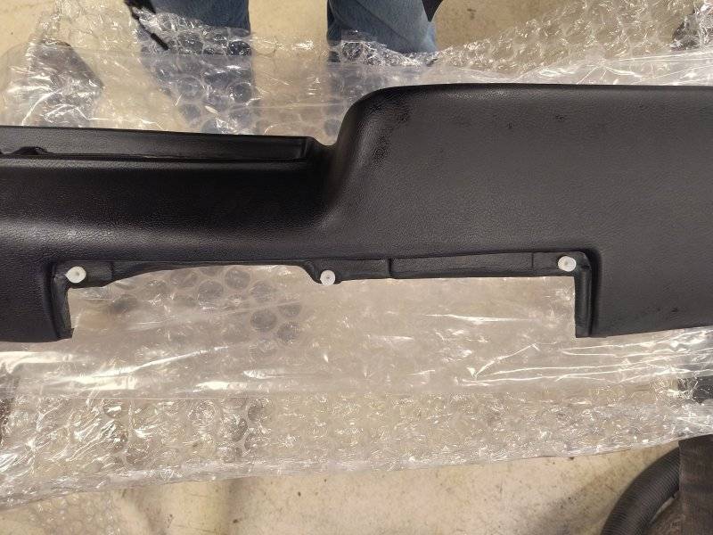

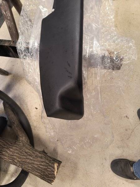

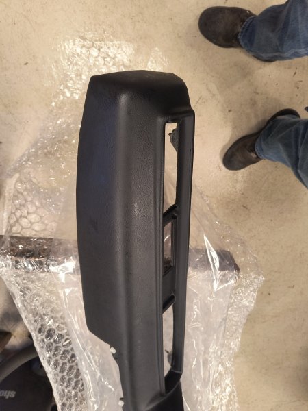

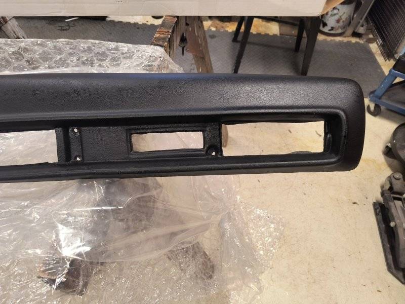

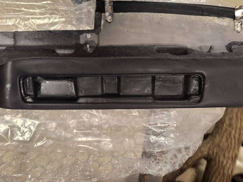

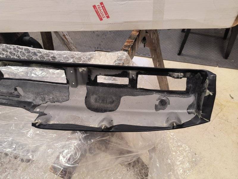

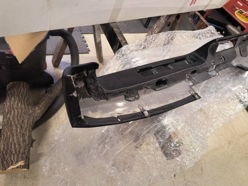

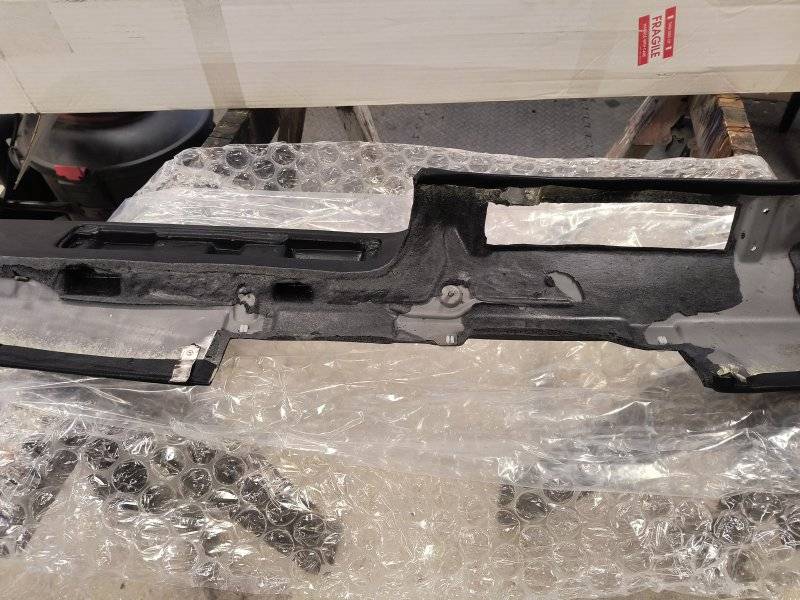

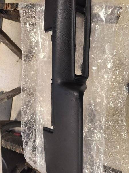

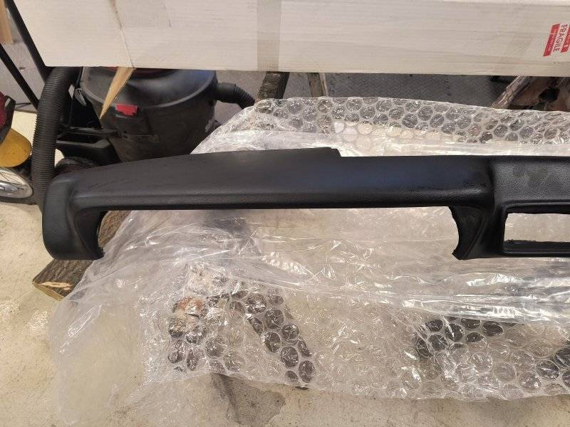

Just got my new dash pad with a steel cor from ABC Moparts. What do you think of it?
it's ok for a driver. Better than having a dash pad with Grand Canyon size cracks in it.
Once it's all installed and fitted properly, clean it with some 303. It will look great. Their pads are the best fitting for our cars out there but like anything take a little work to get them installed properly.

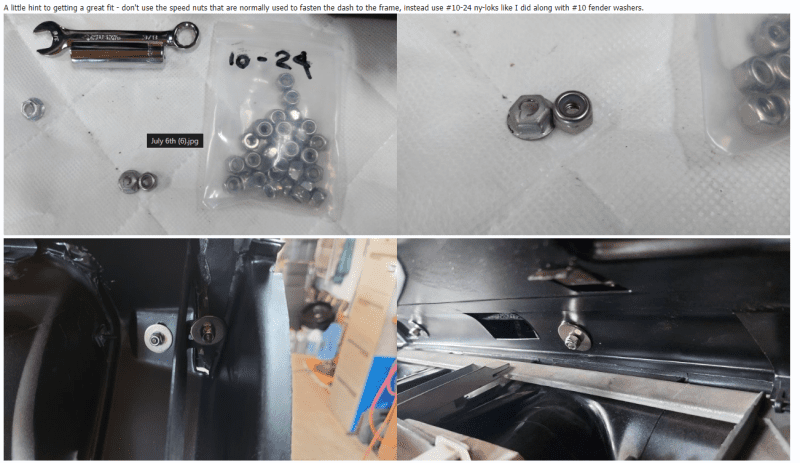

When you go to install the dash pad consider doing this.
I did it when I installed my dash pad in my 71.
The benefit is if the speed nuts do not grab the stud and start to slip - the ny-lok nut will go on with no issues and hold it tight to the dash frame.
