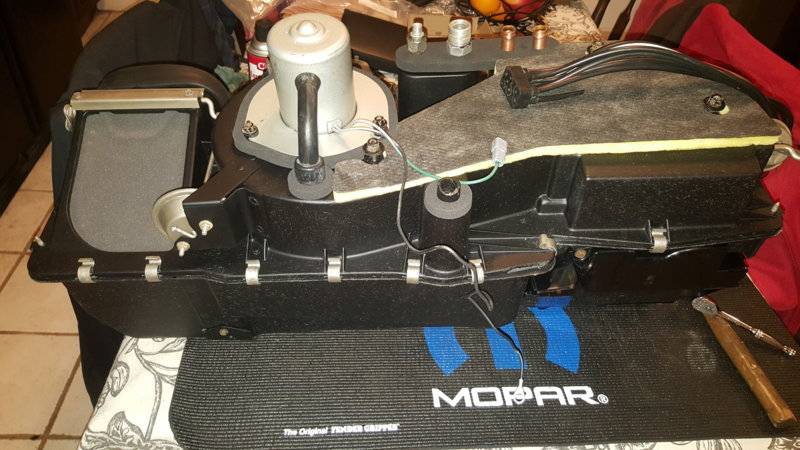

Last year while i was taking apart the interior to replace the floors i figure i would buy a new heater core although i must say the original one looked great. So finally i started working on the heater box since it's cold outside. Got everything from DTM, replaced all the foam, made sure everything worked right, painted everything up and finally got to the heater core.

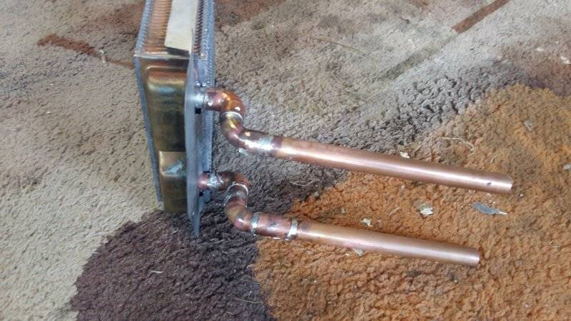

Both are bent and warped and the flange was braised about 1/8 too high so it doesn't sit right. Out of the two i took the better one modified the surrounding flange and took the one holding the pipes off to re-braise it so it fits.
Just wanted to say Spectra stinks! $%#^$%#^$%^ ... 3 heater cores and not a single one was straight. Complete garbage.
Well despite their crappy craftsmanship i got it done... not too shabby looking for 45 years old...

I had similar problem, but local radiator guy was able to take the bracket/flange off the original and replaced the crappy one on the new core with it and worked like a charm, and fits perfect.
Yup same here wouldn't fit..it came from the U.S and I was not going to pay to send it back..cut the tubes off got some 1/2" 90s and pipe and made my own....yes it can be done LOL
