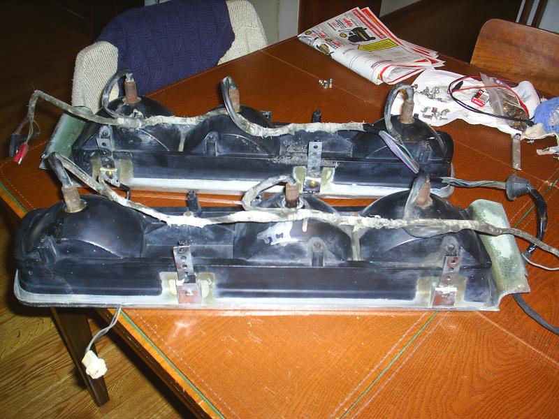

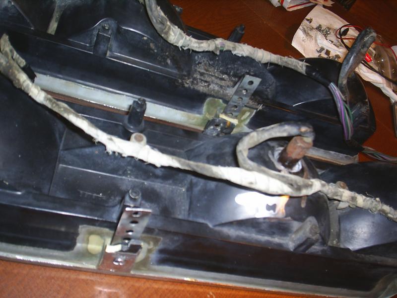

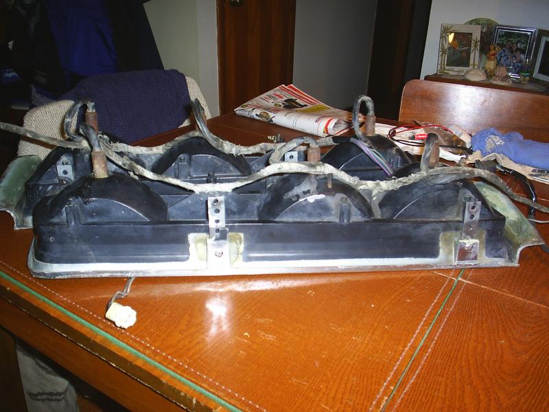

Gage, mine were as well. Unless they are trash, here is an easy fix for them.
Refer to the pics. Get some fairly stiff straps. You'll also need fairly flat headed screws and nuts as to not conflict with the space constriction.
BTW, if you right click and "view image" they should come up full size.

I thank you for the pix too as I have the same problem but will use your pics to do the same with mine!
View attachment 183311View attachment 183312View attachment 183313
