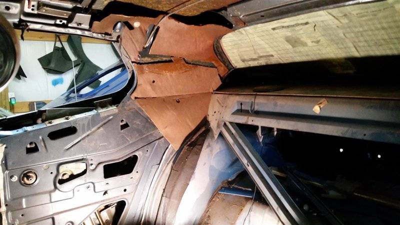

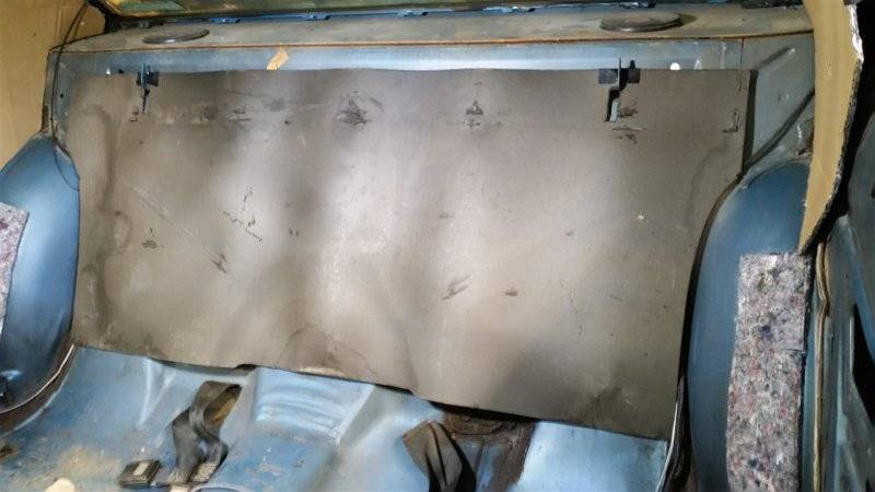

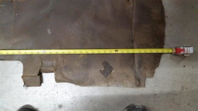

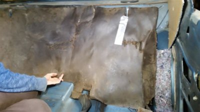

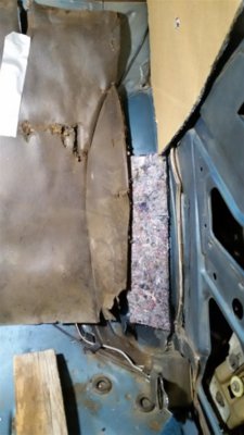

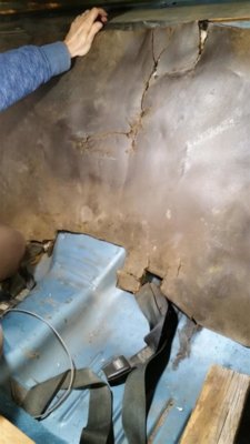

I pulled the trunk divider board out of storage to compare my original to the reproduction board I have. It was not close. Note in the photos the original has "wings" to insulate the wheel housing and it fits great around the center floor hump. I pulled the one out of my other 74 Charger and it matches the reproduction board exactly. The reproduction divider does not match around the wheel housings very well, the same as the one out of my other 74 Charger. So, has anyone else run into this? Any reproduction dividers like my insulated original? See photos. In one photo, I also show an original black piece of insulation attached to wheel housing which seals between the inside rear plastic panel and the wheel well. I replaced it with jute insulation. The original divider wings cover over to the inside rear plastic panel.

The way I show the original in the photo is the way the "wings" fold out to cover the wheel well and is the way I originally removed it with the jute insulation side facing the trunk. I'll have to see if the "wings" fold the other way. Note there's a pre-formed crease in the board for the "wings" to fold towards the front of car.

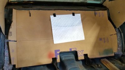

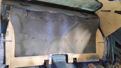

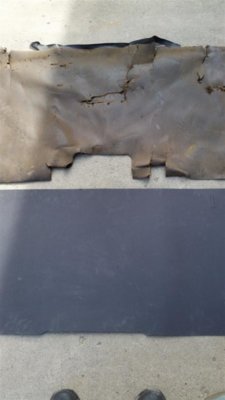

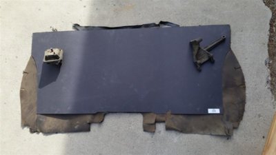

We made a cardboard template from the original and with a few small adjustments, will work. The creases in the cardboard box we used to make the template caused a few problems. See phto 1. Photo 2 shows the comparison between the template and the divider reproduced now.

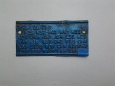

It's has the Rallye package. 360HP with auto trans.

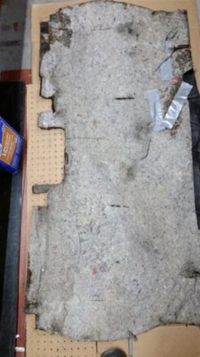

Nacho, the divider board with wheel housing wings is the thick tarpaper type board with jute insulation glued on the back and was installed on the hooks where the black standard divider board is hung. The sail panels also had the thick tarpaper board as shown in my last photo of my first post of this topic. Also note in that photo the black tar paper attached on the wheel housing ( attached with the same white seal rope used to attach the plastic sheet inside panels) . The carpet had a thicker than usual backing. The wheel housings piece of thick tarpaper attached to them, I replaced with the jute insulation as shown in photos and this seals the rear plastic interior panel so no noise comes in from wheelhouse. See photo of jute insulation on back of original divider. The black divider I have hanging in front of my cardboard template in previous photo is just for comparison and came out of my other 74 Charger.
