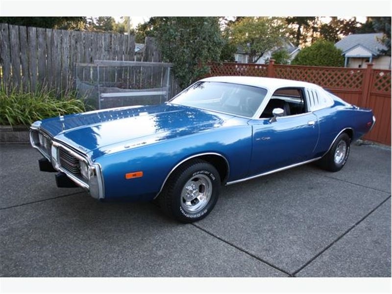

Hi guys, just bought a 1974 Charger (WP29), I knew it was a numbers matching u code 440 car (U4A) on fender tag, 275 hp but to my surprise it also has E86 on the tag which decodes to the HP 375 hp 440. I did not know there were 2 different 440 options in 74, Anyone know more about this?
