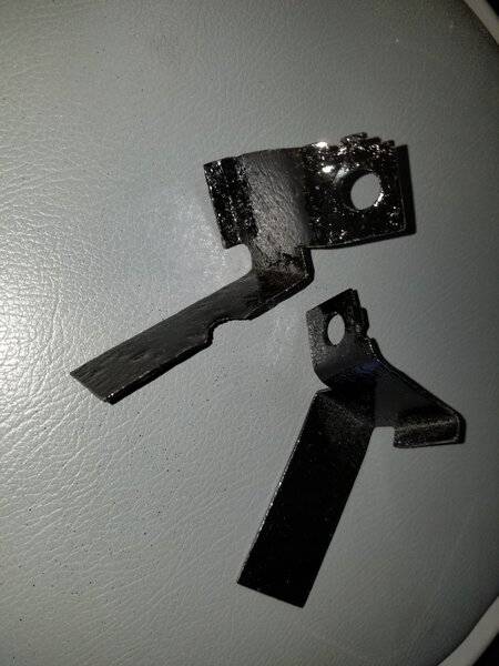

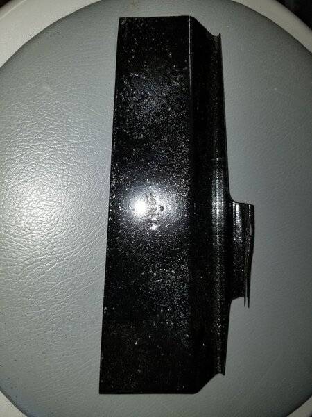

Anyone have any images of the location of these brackets? As well as the bracket that holds the rear brake cable off the axle... thanks

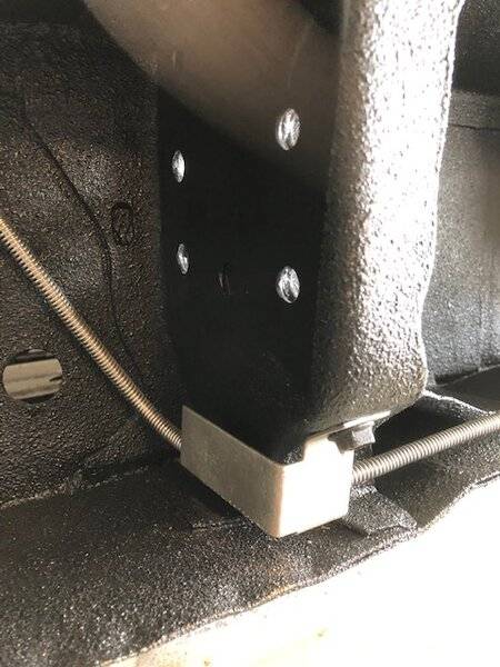

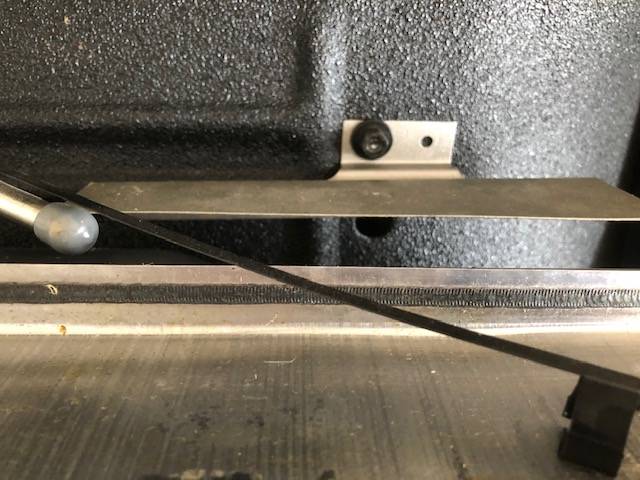

The two small ones go where the leaf springs bolt to the body under the back seat area, to protect the lines. I've attached a photo showing the brake line. The large one is a heat shield between the fuel tank and fuel lines. There is a bolt going through the trunk floor. Hope this helps.
