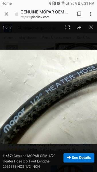

On my 74 heater hoses were black and had white mopar lettering.
The have them in 5/8 also
My 73 had one OEM hose (which Is still on it) and one red hose.

The original hose that's on my car is the one that has the molded foam section around it so it doesn't rub on the corner of the AC compressor.
