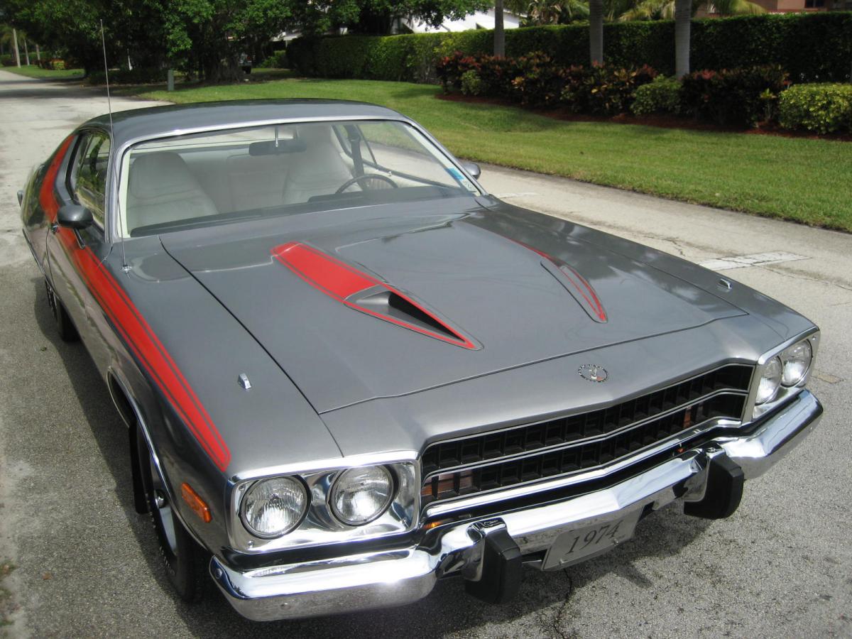

they supposed to be?
Some one have a picture?
Thank you.
In the grille
If you need ant detail pictures PM me. I will be towing this survivor to a show this weekend for a buddy and can snap any photo's you may need.
thanks! I do need to see how they mount.
I was looking in valence for where they should be, there are none behind my grille, just found the bulbs/harness.

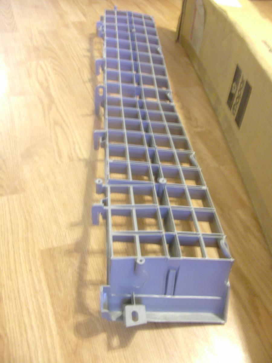

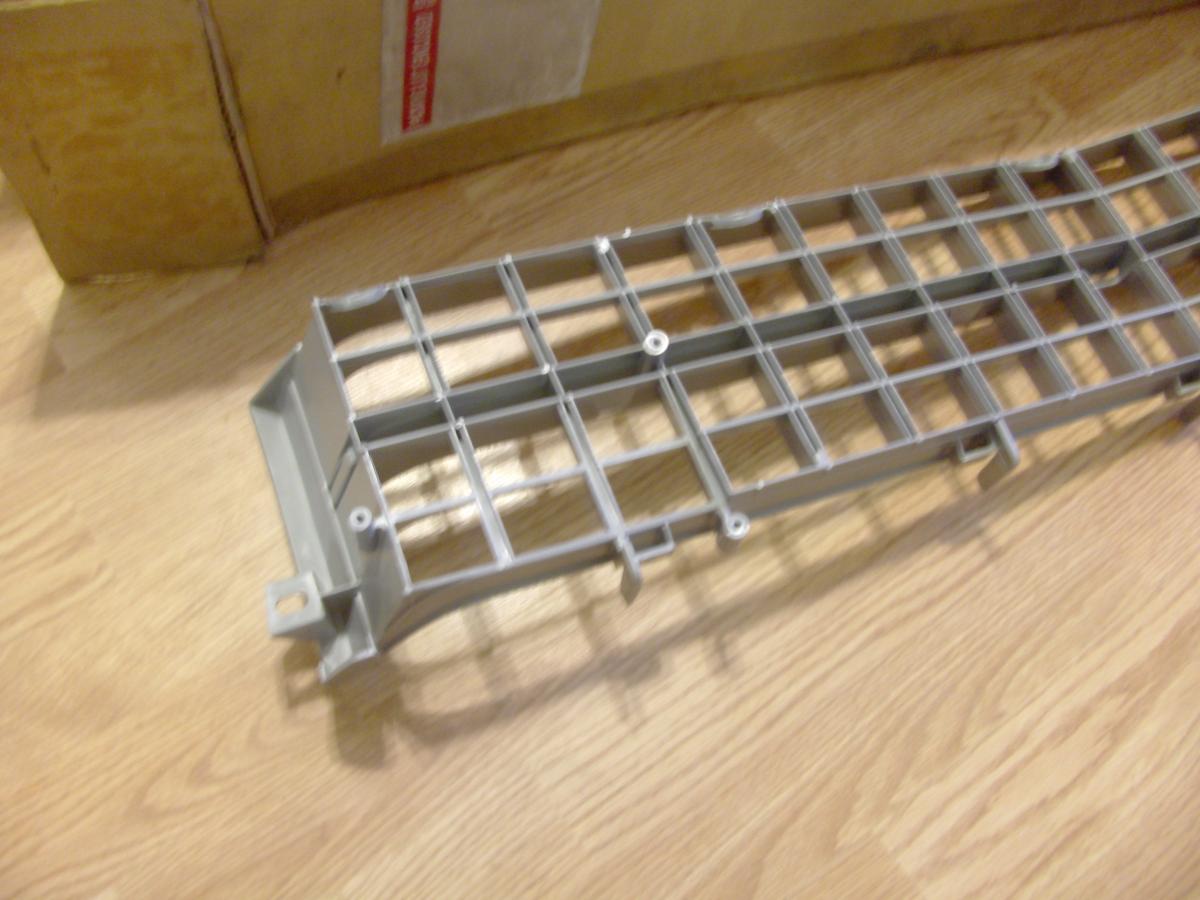

Here are a few pic's of my NOS grill for a 73-74 Satellite/GTX/Roadrunner.....
You should see 3 mounting tabs at each end of the grill closest to where the headlights would be and down close to the bumper....Once you remove the grill you will see how easy it is to install the signal lights...Well unless the tabs have been snapped off.
thank you very much ,that is super helpful!
