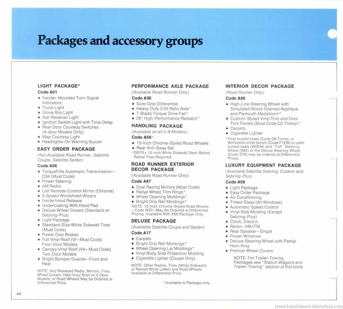

Rear sway bar was part of the package on Charger Rallyes at least
It seems quite diff on Plymouth

Front and rear don't go hand by hand on every car. Since 73 the front bars was more standard on every car than before, and rear was just standard on Rallyes ( Charger ) and what is stated on the attachmemt I posted from the dealer databook catalog to Plymouth.
