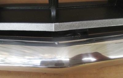

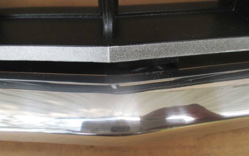

Can anyone advise whether the grill on a 74 satellite is ABS plastic
they are a lot more brittle than any PVC I'm familiar with.

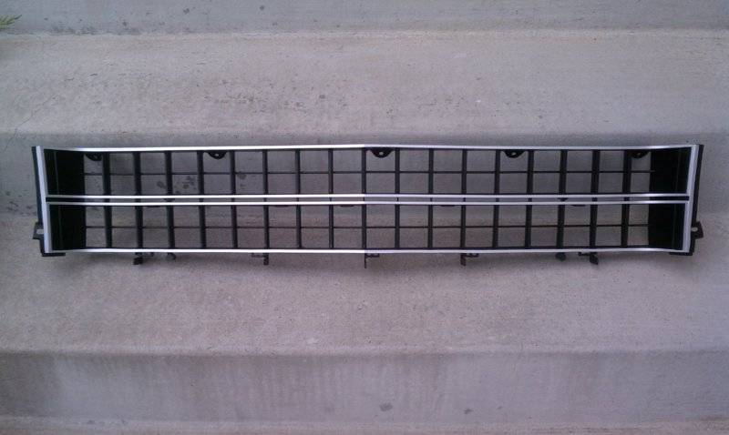

I think the guy that restored my grilles used Devcon Plastic Steel Epoxy, but I think its like JB Weld, the results were amazing, and I used parts from another grille to make the repairs and here we are 6 years later, and no issues.
I used JB Weld to reattach a couple of the mounting ears on mine.
Worked great.
