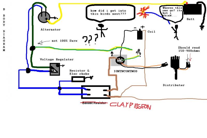

Im sure many of you can relate to me when you bought your car and realized that the last guy was NOT and electrition. And like me you have spent hours chasing down faulty and loose connections. well this is for all of you. i hope it gives you a smile maybe even makes you laugh. In the last four days i have found that the diagrams that other people have posted are about as useful as this one if your not sure where a wire goes chase it. their like birds that return to their nests. it will bring save you time and money. good luck and yes some of this is right, but be warned if it looks different than yours it probably is.
1974 has the seatblet interlock system that is tied into the main harness.
It is junk and can make the carr into an oversize paperweight.
I just finished replacing the entire harness out of a 74 Charger and installed a 1973 harness for simplicity and reliablity.
You really do not have to replace the harness,but the interlock can be disabled and the car will still function normally..
So true that should be the first to go. Extra wire to splice into something else some people must think. Cut it all out I say. If the car runs without it its just extra weight to get rid of. Except the pushbars those are handy.
If you do need a wiring diagram check this link out.. They have a number of things that can help you with your car.. If you have a Auto-Zone parts store around you You might want to consider buying a Haynes Repair Manual, I bought one for my 73 Satellite and im not sorry, all kinds of diagrams, wiring, rebuilding, info on specs for about anything for your car. They may sell them elsewhere but Auto-Zone is where i got mine.. Cute diagram you have there :)
