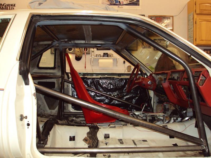

A good portion of the mounting brackets are incorporated in the floor shifter pedestal, and all the brackets are welded to the floor hump. Assume your car has a column shift? If you are converting, your best bet is to find a doner car and cut the whole hump area out and weld it in to your car. stiffener bar.jpg
