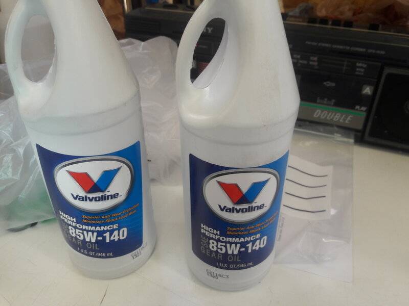

Tucson Differential says no on synthetic. They recommend valvoline and Orielly got it for me in two hours.
