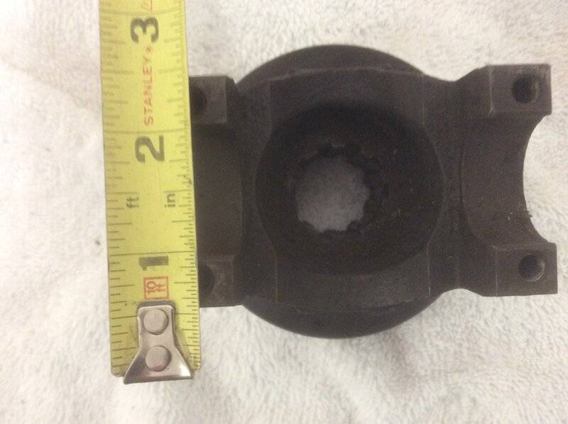

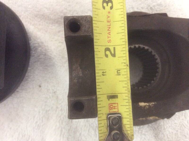

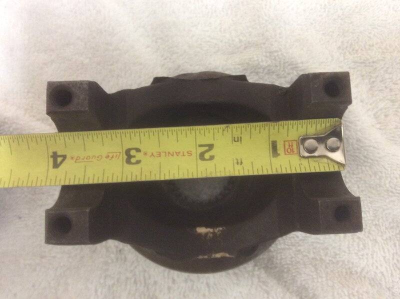

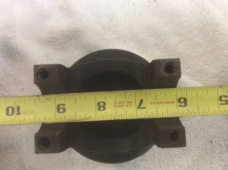

Picture of both yokes. The 741 probably a 7260 u-joint. The 742 could have 4 different maybe more. Three most likely yokes 7260, 1330 and 7290. 7260 will measure 3.25"appox outside cup to cup. 1330 and 7290 will measure 3.75"outside cup to cup. To tell the difference between 1330 and 7290 yokes is the 1330 has a small tab to hold cups in and cup diameter of 1.0625". 7290 has no tabs but inside of yoke is machined flat so clips on u-joint cups hold cups in place. Cup diameter is 1.125" on 7290. Combination u-joints are available for them. First 2 pictures 7260 pictures 3 and 4 are 7290. No picture of 1330.

As TN Mopar said you'll need to change the u-joint. Your driveshaft probably has a 7260 u-joint you'll need a combination u-joint. Post a picture of driveshaft u-joint with a tape measure visible. Also picture of yoke in 742 with tape measure.
