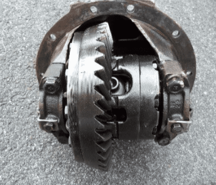

A cone is typically found in a 489 case from factory..........

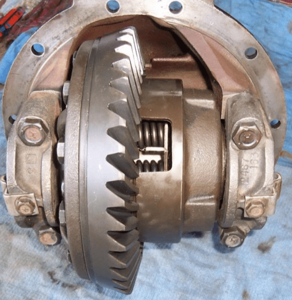

A clutch SG will also fit a 489 but typically are found in 742's.......
Maybe @Cranky would know.
OP needs to know what he has. Any pictures before you installed it or did you install the whole complete housing, drum to drum?
Cone type unit. And do not keep trying to make it lock up because it will not. Need to pull it back out and open it up and check it out the parts inside. Chances are if it hasn't been hammered to death it can be machined to work again. And you do not need to take off .100" from the faces to make it work again. It's a little bit of work to open it up but that's not that hard to do and I can walk you through it.
Any idea how much is machined off the cones? I assume the shims are the same thickness as the amount machined? Just curious.
The side gears clearances to the spiders will dictate how much shims to use if needed. Generally I've machined them the first time without adding shims unless there's too much clearance in the spiders....
