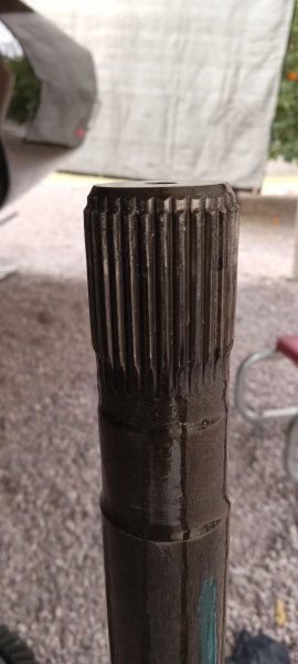

Working on a 69 b-body with a 489 center section cone limited slip. Housing is 55" axles are both just shy of 29 1/2" flange to the end. One and maybe both axles are barely engaging the inner splines of the center section. You can see in the picture it buzzed off the end of the splines on a test drive.

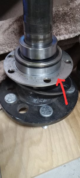

One is on the inside against the snap ring on the bearing. I'm not familiar with them I use tapered bearings myself.

Did you remove the old axle seal? With the o ring bearing, you don't need it.
Why is the extra retaining ring still on?

BOB RENTON
This looks like a spacer. Is the C-clip under it?
Might try removing it and see what you have for proper length. I'd remove the O-ring first, remove the spacer then reinstall the O-ring. Maybe it won’t slide over the bearing?

If that was true the brake drum would be also sticking out about an inch or more from the backing plate.
1. It has to have green bearings for the disc brakes
2. The plate slips right over the O-ring it just sandwiches the snap ring to the outer retainer, I'm thinking it's not needed.
3. It is a possibility the bearing and spacer could press on farther. I'll play with it more tomorrow.
If the bearing was not on all the way how can the rotor fit properly?
