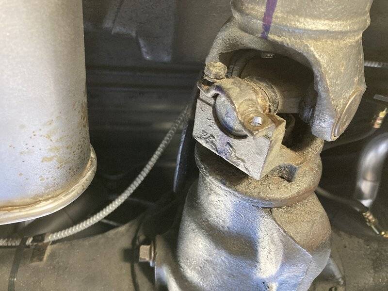

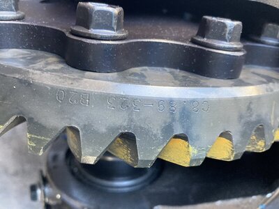

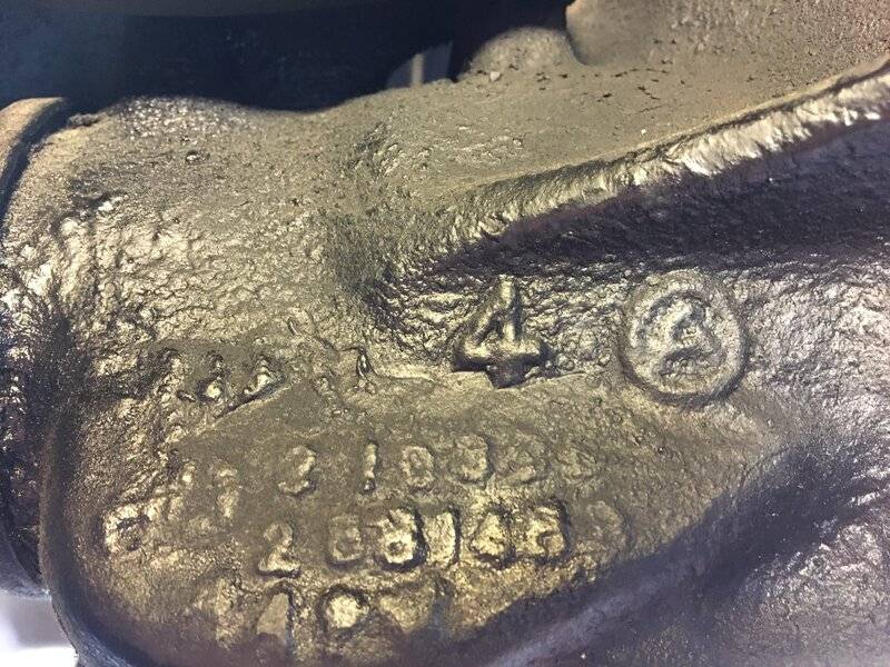

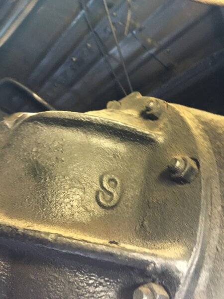

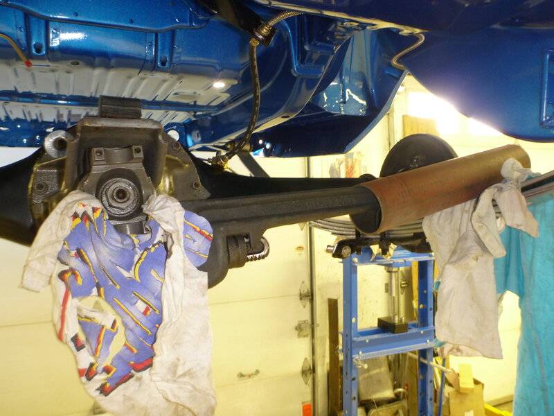

Thanks so much for the responses everyone! It is an 8 3/4 and 3.23. Here are pics of the case and right before I dropped the driveshaft.

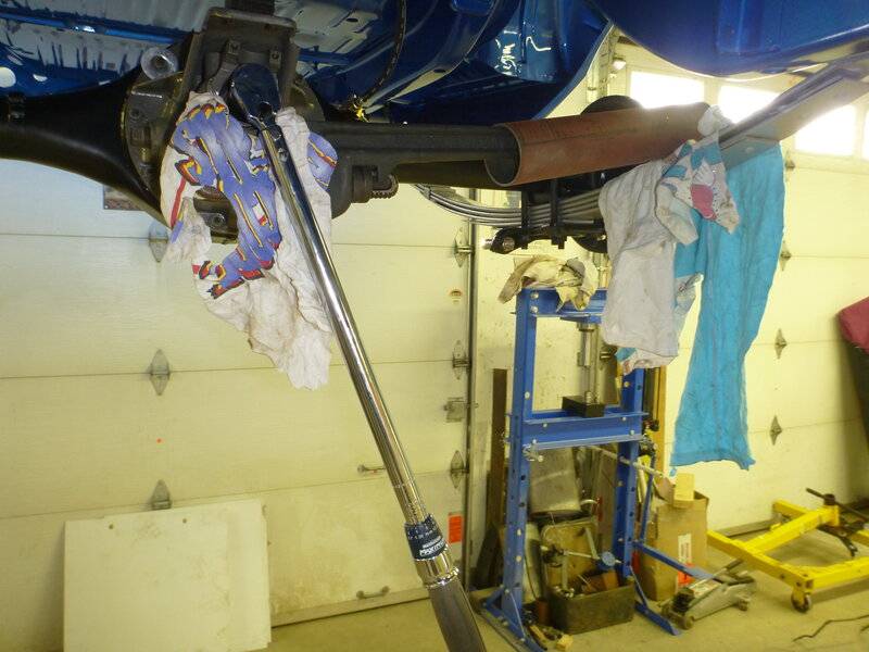

The nut torque on a 489 is 175 foot pounds minimum.
However it is hard to check the bearing preload with the diff fully assembled.
Just got a large torque wrench and breaker bar to finish front end. Looks like I can use it here as well. Thanks!
View attachment 1267236 View attachment 1267237 View attachment 1267238
89 case and came with a crush sleeve in it from the factory. Whenever I build one that sleeve gets replaced with a solid spacer and then it sets up like a 41 or 42 case. I've seen the 89's with collapsed crush sleeves before. Best thing to do is pull it out and tighten the nut up some. If it locks it, it needs a new crush sleeve. You could also do that in the car with the axles pulled out but then you will need an impact wrench to 'sneak' up on the nut. Or, if the nut is loose, tighten it up with the axles in and wheels on the ground....then pull the axles out and see how many inch pounds it takes to turn it. Pain in the butt no matter what you do....and block the wheels if you do this in the car.

Got a feeling your going have a noisy rear after tightening, hope not. The stress to snap that 1/4x 28 bolt says something even for a small bolt.
Is it snapped or was he already taking the driveshaft out and then took a pic? I looked at it pretty close but couldn't tell.
