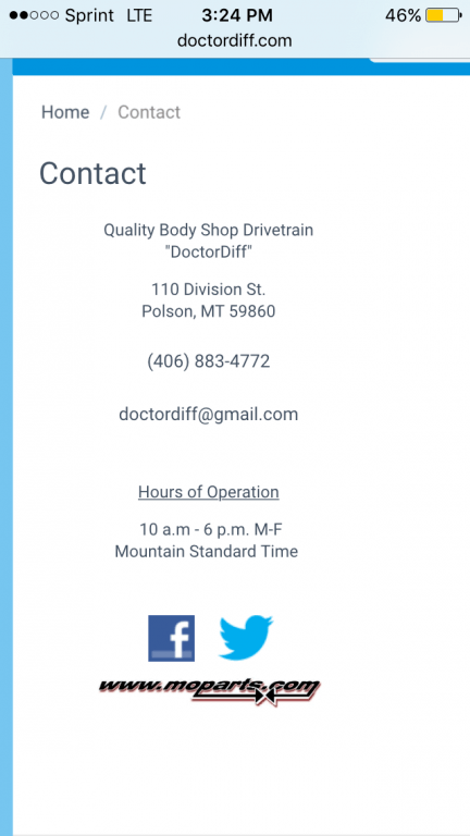

Anyone have a phone number for dr diff? Tried calling but it says not in service
I called last week to order my Dana using the number on the site
