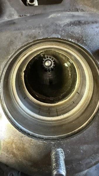

I've been prep'ing the Bee for new drum setups on all 4 corners and noticed a potential axle issue on the rear driver's side. The drum had (it's been cleaned) a lot (like a lot lot) of grease in it and I've removed the half-shaft to clean and inspect. In transparency, my rear end & axle knowledge isn't as solid as other areas so I'm looking for some input and advice on what I'm seeing:

My gut says these dents should be a concern but want to validate. Additionally, other than visually inspecting and feeling for damage on the shaft and inside of the housing, are there other items I should keep an eye out for? Am also planning to clean out the vent.
If your going to replace the bearings the new kit will come with new retainers.
Or like ckessel posted just file that dent.
Make sure to keep the fillings out of the bearing.
Plus remember to pack that bearing with grease if your useing it.
Look it over close for signs of galling , flaking ect.
I wouldn't worry about the dent, as others have said, but the grease on the drum is concerning. The outer seal, which is hard to see assembled, just behind the retainer, is a concern. Now, having said that. If the extra grease on the drum was caused by over-packing the bearing or a clogged axle vent; you might be able to just clean, file the dent on the retainer collar, and reassemble.

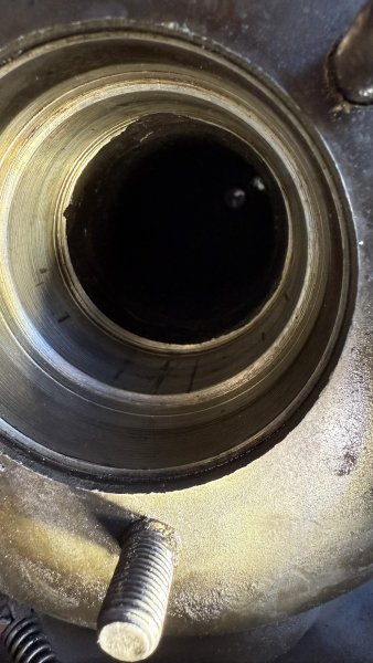

2) The area around the seal stop looks rough. My understanding is the seal doesn't necessarily push against this but not fully confident if it's an issue or not:
1 Yes, and replaced as well usually. I remove the retaining collar with a big chisel, big hammer and my big arm. Strike hard every 90* and the collar will expand and can slide off. Side cutters for the bearing cage and the rollers and cage are out. File a pair of grooves in the inner race and whack with the chisel again, it should split. Use care not to nick the axle.
2. Use a little sealer around the inner seal when driving it in if the bore is scarred.
