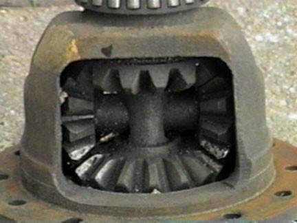

#1 - Open

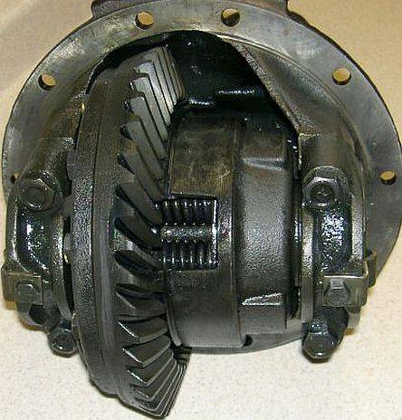

#2 - Cone style SG

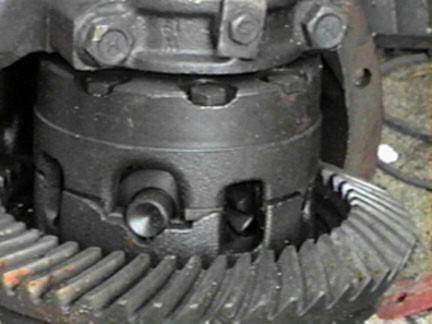

#3 - clutch style SG
