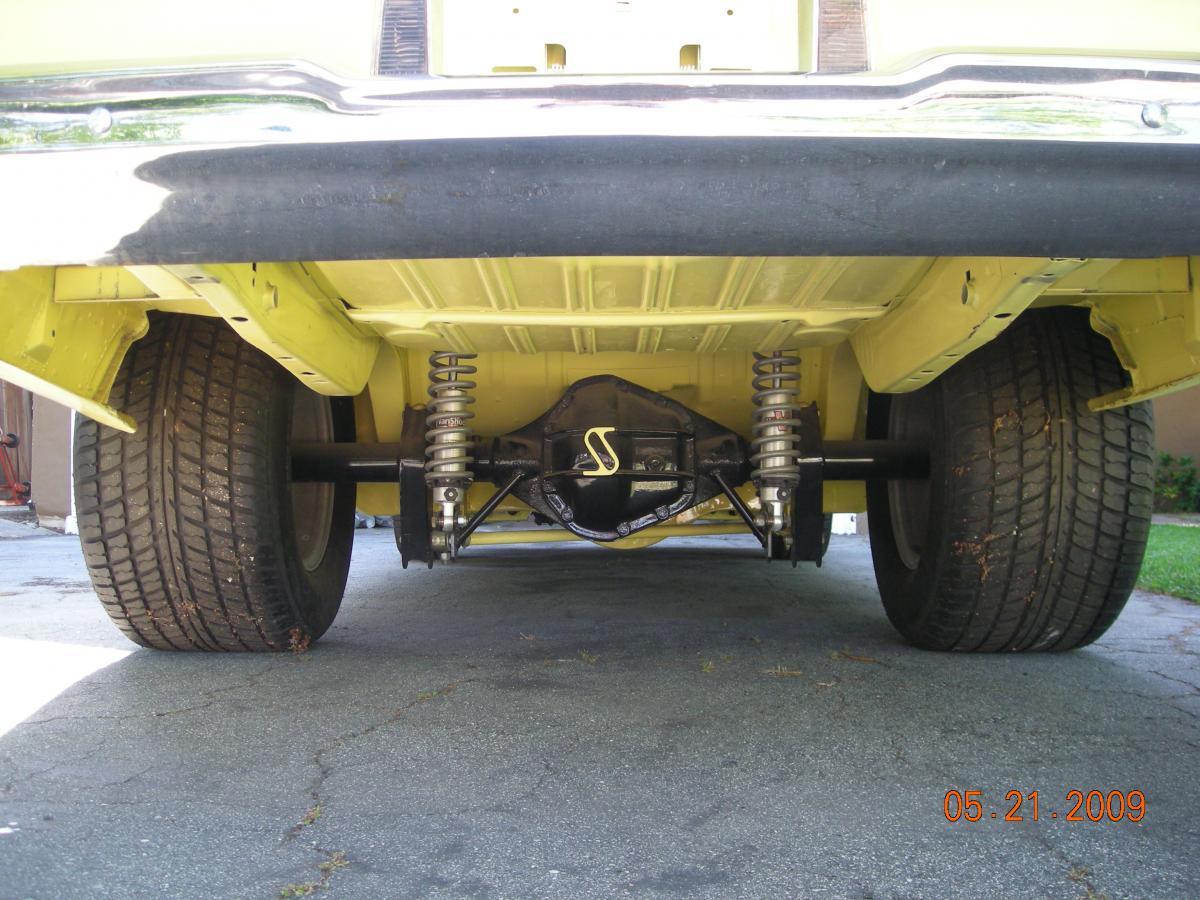

Not easy at all in my opinion. Went for the Dana 60 on my build. If you are not making real big power I would not change anything. I spent a ton of time and money to make the change.. Here is the finished project..
