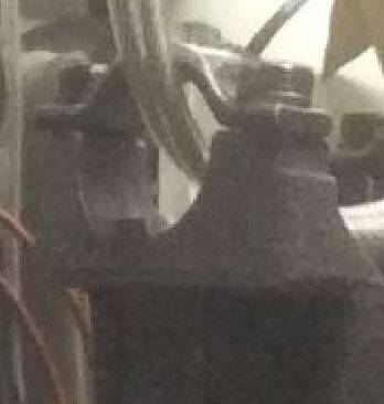

Hello. What yoke does the 8 3/4 axle on a 1964 polara use? Its a factory 426 street wedge/4 speed car if that matters.
I have an empty housing im going to set up as a spare with a more aggresive gearing, and i would like to order parts to it now. The car is garaged 14 miles away so i would prefer not going all that way just to measure the universal joint :)
I “think” it’s a 7290.
If driveshaft rear u-joint has outside clips and is 3.625 wide probably 1330. Cup size 1.0625". The yoke will have tabs to hold cup in place. You can see tab in pic.
