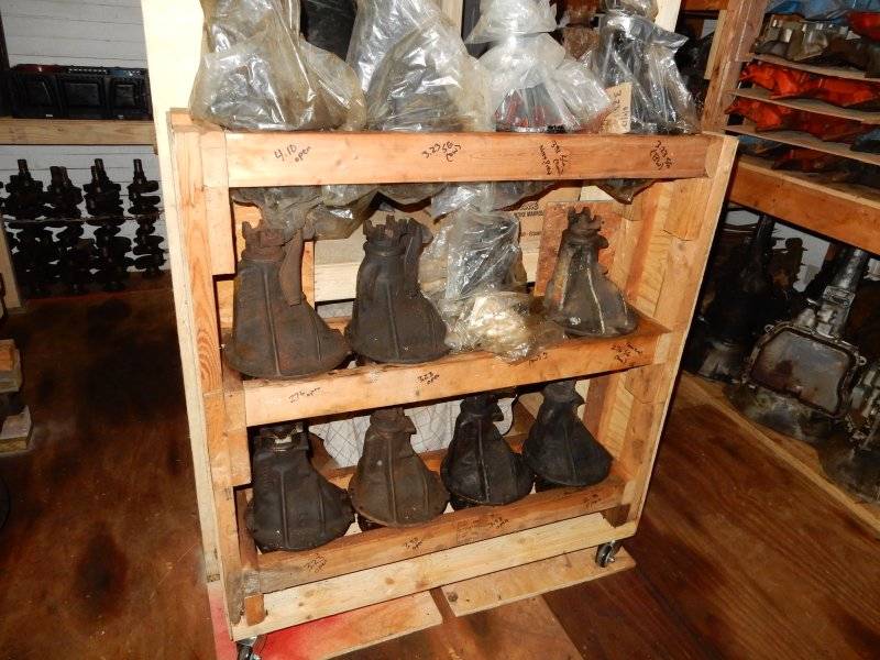

To store my 8-3/4" differential assemblies, I built racks:
They are constructed from 2x4s, plywood, and four casters. Each one can hold 12 differential assemblies, and can be rolled around as needed.
These are in an old storage house that is reasonably dry. Some differential assemblies that are clean and ready for use, are wrapped in plastic for more protection from dust, and the others are not but those will be cleaned when used.

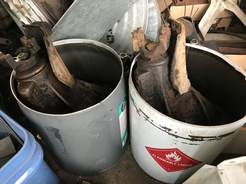

I've been storing them like this for over 45 years, a small scrap of plywood keeps the ring gear off the bottom. 5 gallon thinner can with the top air chiseled out. Hammer down any sharp edges and drop the carrier in, add more oil if you want. I tried a 5 gallon plastic bucket once, it cracked, what a mess. I store power steering boxes this way too.
