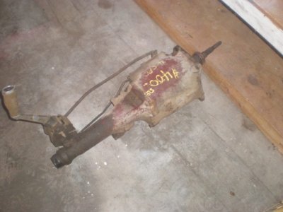

I just picked up a 4 speed that I was told was out of a 70 Cuda can anyone help me ID this?
8G180392
PP833 2282 0035 on stamping boss
E4
C 97622 and a C-95664 -2- 9-25 on side cover and C-98638 on tailshaft
8G180392 says it's from a 68 car. The other number 2282 should confirm the production date if you had the calendar to look it up and the last number 0035 might be the 35th unit built that day (I think). A 70 tranny should have two shifter locations on the tailshaft with the B body location closest to the case.
Thank You, I didn't think this was off a 70 but it does have the two shifter locations.
this is a 70 up
