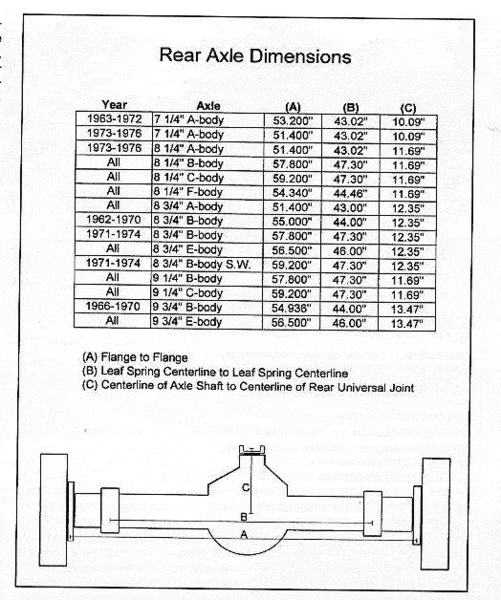

Here, I took this from the other thread on the first page:
I haven't gotten any info off of it to find out exactly what one it is though.

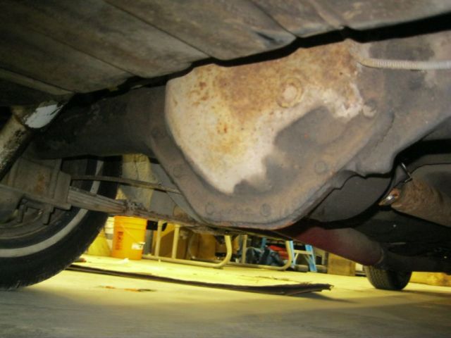

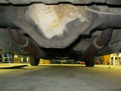

'74 9 1/4" rear
Here's a pic or two from my '74 satellite, I literally discovered tonite that there was a 9 1/4" in there, and didn't think they were in these cars yet. Just assumed it was a 8 1/4" What was the gear that they started with in the 9 1/4" rear? 3.23? Maybe '74 was the first year of this axle?
-Jim

Thanks. I'll get some pics of mine up. One of the things I'm trying to find out, is if I can put your type of axle shafts in, in order to go to 5 lug.
I've seen that chart before. It's not entirely correct (esp 62-70 8 3/4), and there's a better one out there, but it's harder to find.

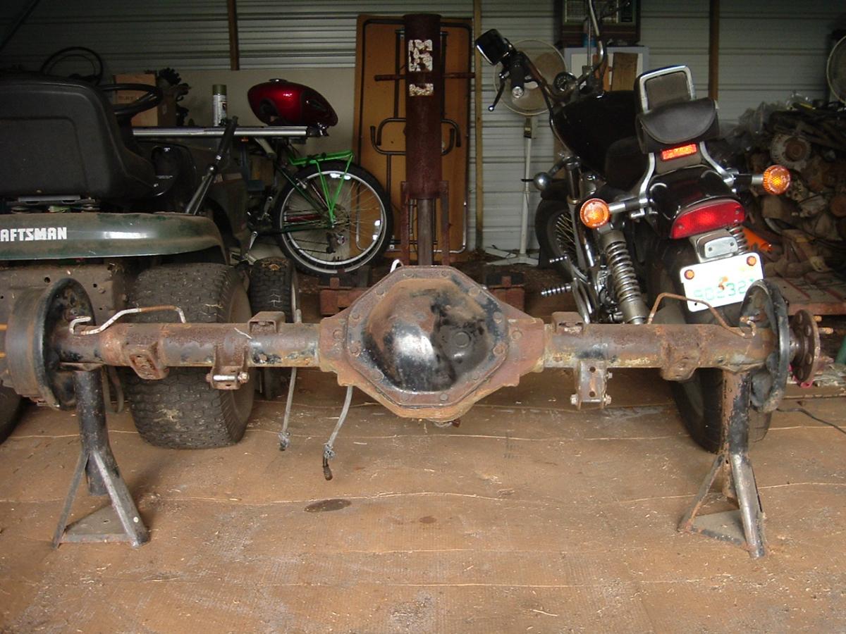

OK, here's a pic.
It measures 57 at the backing plates and 43 at the perches, so according to the chart, it's real close to 66-70 perch and 71-74 backing plate. Hmmm.
Drivers side measures 31 from backing plate to pinion center, but pass side measures 26ish. Double Hmmm.

BTW I measured an unmolested 66 8 3/4 and it is 52 to the backing plates +-, but NOT 55.

Guess we'l just have to mount it up and see.
