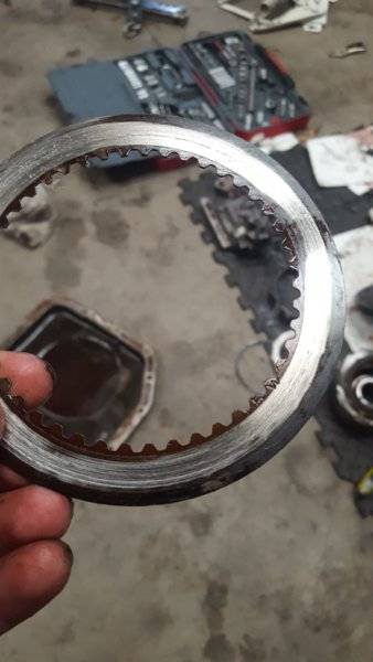

So an update on the transmission. Adjusted the band's. It really improved the 1st to 2nd shift. 3rd was still no good. Well it was time to get down and dirty. Pulled the motor and trans out. Split the trans apart and found the rear clutch had two plates with very little friction material left. One plate was bare without any material and shinning. So the problem was found. Now to find the cause of the issue. Pump was fine. Converter was good. Valve body was in good order and clean. The clutch piston was the issue. It was hard and had a slight rip in the rubber.

The reports are not over yet. It's rebuilt but the car doesn't move yet. Fingers crossed it will hit the road this weekend. Here's a picture of the guilty clutch plate
The rear clutch is applied in all forward gears. The forward clutch is the only component applied along with the rear clutch to provide 3rd gear. Take a good look at the reaction shaft support ring grooves, front clutch inner sealing surface that rides on those rings, inner and outer font clutch piston seals. Any of these would cause slow engagement of the forward clutch. The rear clutch would cause an issue with all forward gears. That being said you may have not noticed the slip in 1st or 2nd gear.
