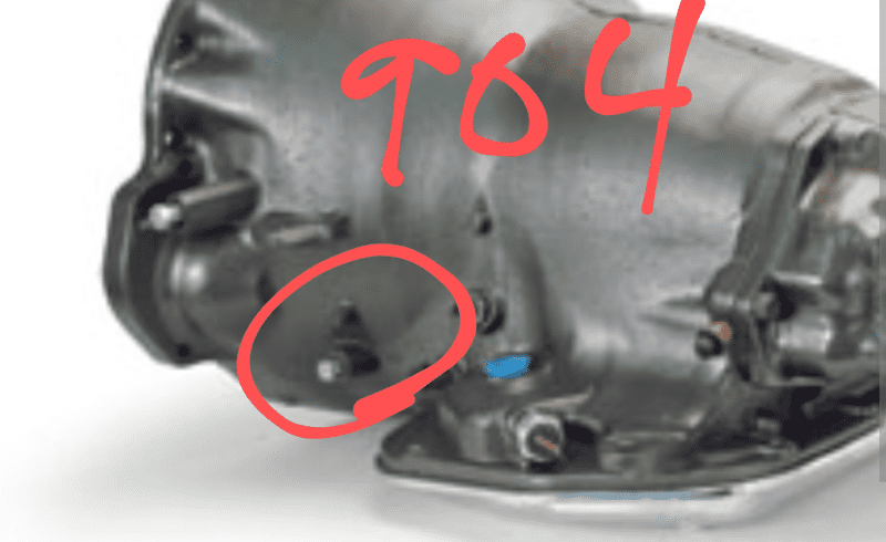

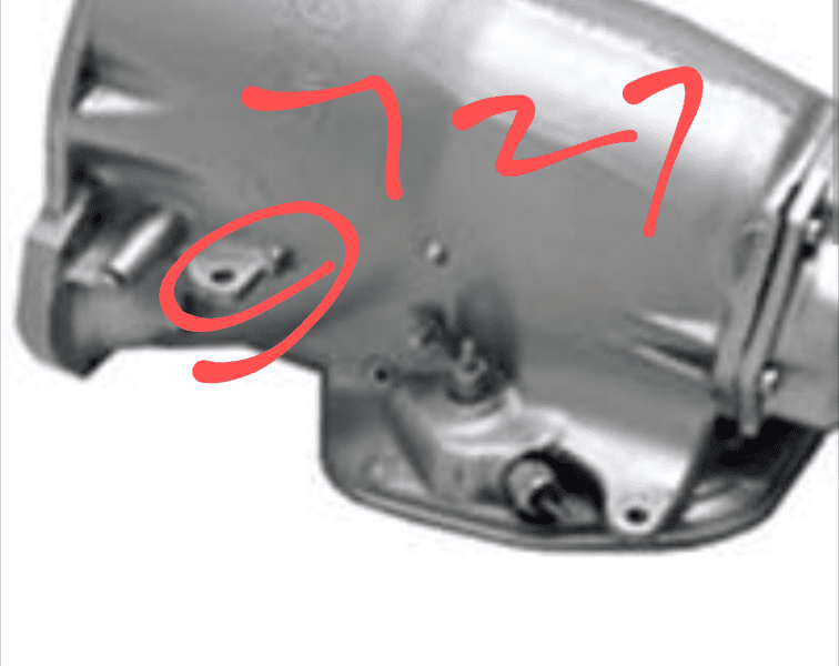

72 Charger, column shifter that used to have a 360/904 and now has a 440/727. I want to keep the column shifter and have all the linkage. But, as you all likely know, the drop mount for the linkage on the 727 is a lot higher than what's on the 904.

Everything fits except for the drop bracket that holds the bar from the frame to the tranny. In the 904 there is a low bolt hole where the short bracket goes. On this year 727, it does not have the low hole, only the high "ear" on the bell.

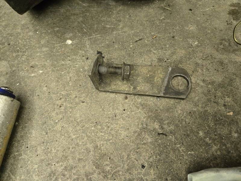

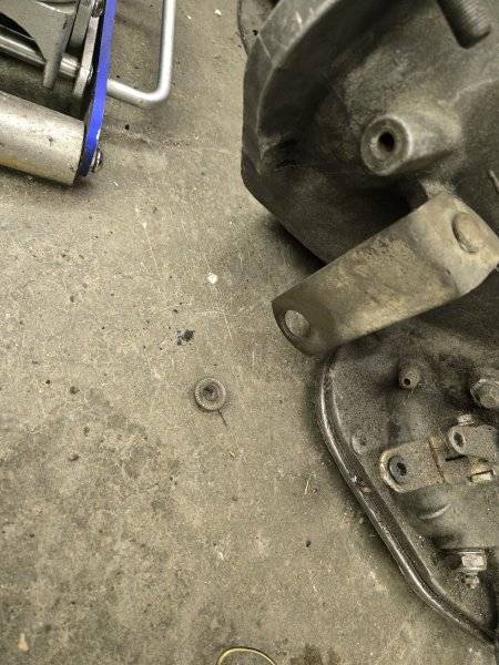

Not great pics, but i have only the mount circled on the 727 but the brackets for the hole shown in the 904 pic. So need a longer bracket
71-72 727's with column shift used the lower mount like on your 904. Maybe find a latter model bracket or fabricate something?

Yeah... before I try to make a bracket, I was hoping someone knew of a part that might exist. I swear I saw a guy write about a Dodge van that had the bracket... but I can't find the post and he didn't say what model/year. I would imagine I'm not the only one who has a column shifter location issue for the 727. Just hoping I guess. I'll probably just make a bracket. Not a huge deal, but was trying to see if there was something out there first.
