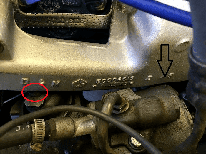

I semi-mocked up a set from a 200 Durango on my 73 318 when I was putting it back in.
The issue is that the passage that goes from number 1 to number 3 cylinders hangs very low, and will most likely contact the adjustment shaft of a power steering box.
I've heard of one person grinding 1/4" deep groove in that area- seems like a LOT, just how thick is this casting?
I've also heard of someone cutting the "belly" shaped portion out, and welding it back in upside down.
I've even thought about cutting the PS adj shaft down and slotting the new top for adjustment, but then how would you get to it with the manifold in the way- not that I've ever had to actually make that adjustment.
I'd LOVE to hear from anyone that has them on a PS car.

Way too close for my comfort. Only seems to be an issue on iso-k cars though.
That's interesting as the ISO cars actually have 3/8-3/4" more room top to bottom.
Note also on the FEBO thread that it looks like the pass side is touching the trans dipstick.
I noted this on my test as well.
From what posts I can find, there seems to be a difference between Ram, Jeep, and Dakota manifolds. Also, the only center dump manifolds I am seeing are pre-magnum.
