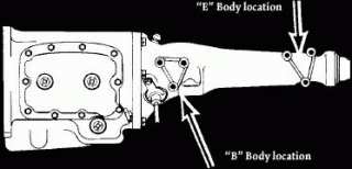

I dont suppose you have a photo that illustrates the two locations or one that shows just a B or E body?
dual pad 833

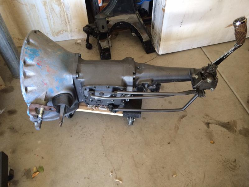

This set up is for an E-Body, can see the forward pad for a B-Body
When the E body came out, the dual shifter patterns appeared. The earlier B trans have the single pattern forward mount pad. Didn't need anything else until the E cars showed up.
