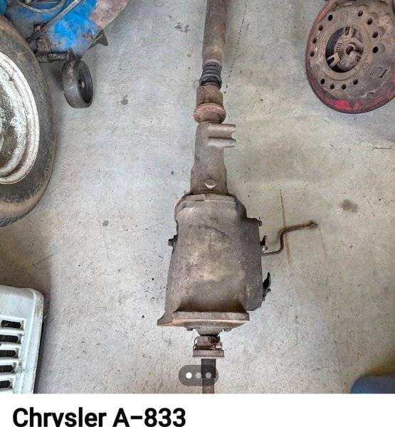

Hi all, working on restoring a 68 charger,
Were making it into a 4 speed, will a 65 A-833 work in the 68?
Thanks in advance
The 65 A833 will have the ball and trunion style output. Most people prefer the slip style output and drive shafts. Nothing wrong with the ball and trunion they are just expensive if they need rebuilt.
That one won't work for you. Besides the ball & trunion issue, that transmission is for an a body?? mopar. The shift mount boss is placed too far back for a Charger b body.
This site may help you in identifying different a833 transmissions.
a b-body trans.......
