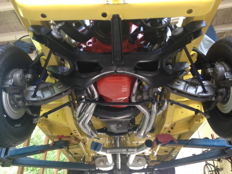

Hey Props. Here is a photo showing the 73 Duster I restored a few years ago. In this picture it shows the complete steering assembly as seen from underneath. Hopefully this will show you what you were looking for. I agree with what was stated above. I don't think there was any difference between /6 or V-8 cars other than the torsion bar sizes.
This is a 73 model year so you might be able to see what the difference is between a 72 and a 73.
Hope it helps with your quest. I have a BUNCH of A body restoration photos so shoot me a PM if you have any questions. image.jpg
Awesome!! Thank you for that. Nice to have a decent underside pic! Thanks again and that's a very sharp/clean looking Duster you got there. If questions arise, I shall come bug you sir!
