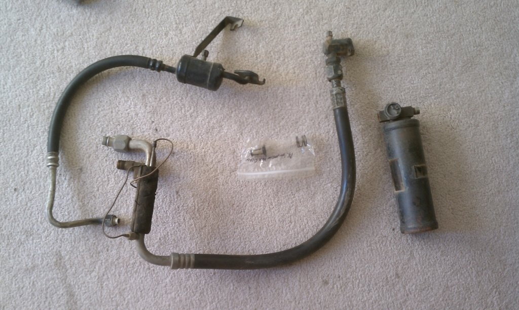

Also, if you don't have the compressor or any of the parts for the ac itself, you will need a compressor(RV-2), drier, high pressure and low pressure lines, evaporator and condenser.
Here are the lines and the drier.

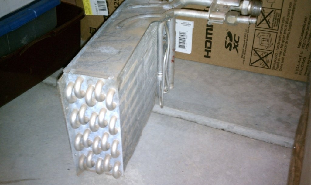

Here is the evaporator
You will also need a heater box and the vacuum lines that run all the vents in the heater box. Also, there are a couple of smaller parts to the duct work on the heater box, but I don't have any pictures of those, but they go in between the box and the vent ducts.
