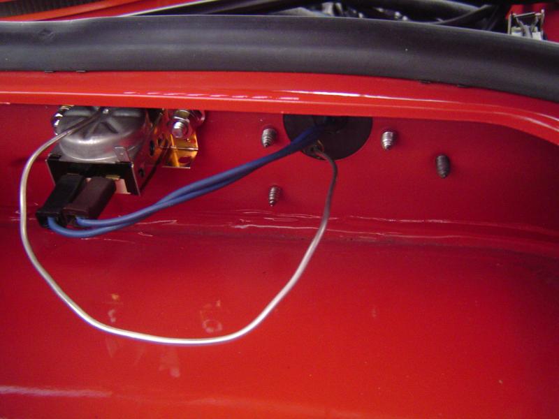

So, if you have converted to 134a, you need an external cut off switch I am told because the EPR valve is removed on the compressor in conversion type setups. So this type with capillary that you lay over the low pressure hose, typically next to where the expansion valve capillary goes. The one from classic broke, part of the housing separated mis-aligning it so it would never cut off. I found the Murray 35720 at Oreilly, for only 17 bucks, much less expensive than the one from Classic, and a better built part.
Here is what it looks like, which is actually different than their standard picture on the web site. It also has cut in and cut out adjustments on it, if needed, but comes set to freezing.
Here is where I attached the capillary, using some heat tape to secure it to the pipe.
I installed mine in the cowl area, because putting on the fire wall it just gets too hot, and that may have led to the other one failing because it sat just above my headers.

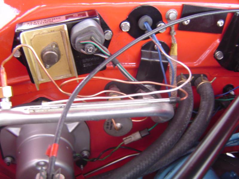

Everything you said, completely correct. However, everyone has told me that in order for it to work "properly" it should have gone into the heater box on the evaporator which is what freezes up. Putting it on the outside is not the correct way to do it because heat from the engine gives it an incorrect reading.
But I see you remedied that issue by putting it on the other side in the cowl vent area. I actually thought of that but wasn't sure it would work.

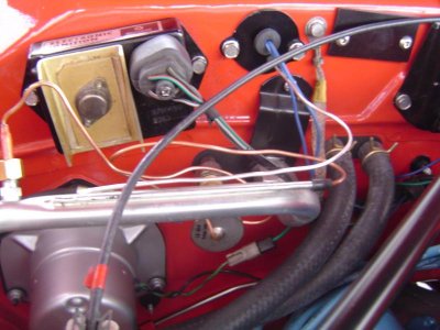

I learned most of this myself when installing my conversion. As IDrive stated, you need an external cut off switch, because the EPR valve is removed on the compressor in conversion type setups. So as is pictured in mine, you lay the sensor over the low pressure hose, typically next to where the expansion valve capillary goes. But the problem is no matter how much insulating material you put over the sensor, the heat from the engine warms it so it would never cut off. That is the problem I am having.
The old compressor had it built in, these are not therefore you need a separate thermostat basically. But it should be in the heater box next to the evaporator which is what freezes. Instead they give you this contraption which doesn't work properly.

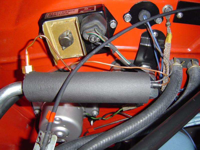

Hey ODZKing, I see you placed your switch almost exactly where I had mine, and why it failed. Also, I have wrapped the capillary and section of pipe with reflective heat tape, then used a section of pipe insulation so it looks like this.
I was getting some condensation and frost on the pipe and even up to the compressor with this setup, so seems its insulated enough to prevent the heat from having too much impact on the switch working properly, however, I think I have a slow leak some where, as I have been testing, the system is not getting as cold as it was when I first charged it, so back to checking pressures and trying to find the leak.

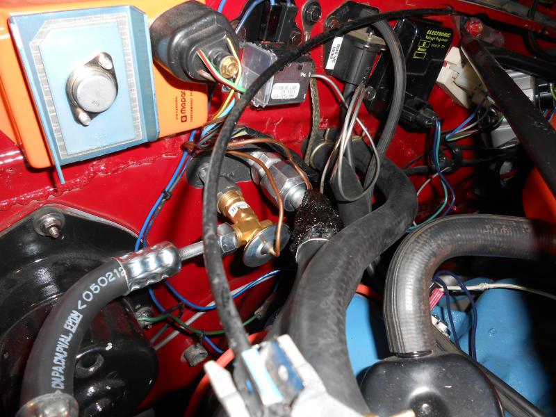

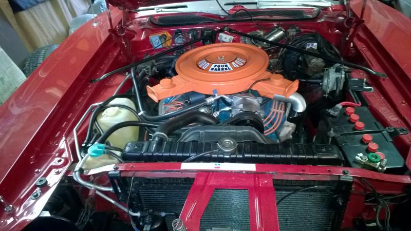

I also noticed that your low pressure pipe seems to have a different configuration.

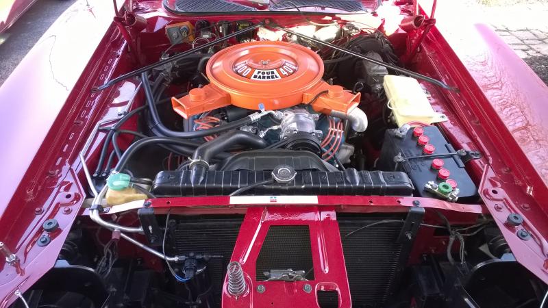

Mine is a 73 Charger and had factory A/C. When purchased it was missing most of everything under the hood, so all I did was convert everything as per CAA.
That is what they sent.
Yours does look much different ... different year? B Body?
Mine is 73 Roadrunner, small block. Fire wall should be nearly identical. also, the high and low pressure hoses are original to my car, just upgraded to handle 134a. I am running the RV2 compressor, are you using a different compressor then?
Ahh, my hoses came from CAA, orig ones were gone when I got the car.
