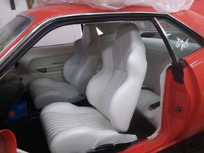

If you have been following along I`m working on a `70 road runner ( thread here- `70 road runner, FC7, 383, 727 It`s waited long enough, finally time to get it done. ) and I have a couple decisions to make. I am doing a 90% stock resto on it with a couple add ons like an air grabber hood and Dust Trail stripes along with a few Day Two mods such as period aftermarket wheels, headers/exhaust etc. First is the easier one - car came four wheel manual drums but thinking of putting on front discs as I do drive my cars, many times a bit hard and fast so it would be more for safety. Second is the hard one I am agonizing over a bit - it came M2X9 mediium grade black bench seat but I am thinking of changing it over to white as that just makes the FC7 pop so much better than black interior and is my favorite color combo on a Mopar. Both are easily changed back (interior is more work/cost though) if myself or the next owner (after I`m dead) wanted to but the interior color change to me is a major mod from the fender tag (I don`t have a broadcast sheet). I know the "it`s your car, your choice" response but I`d rather here more form the stock type/resto guys on this - thoughts/opinions?

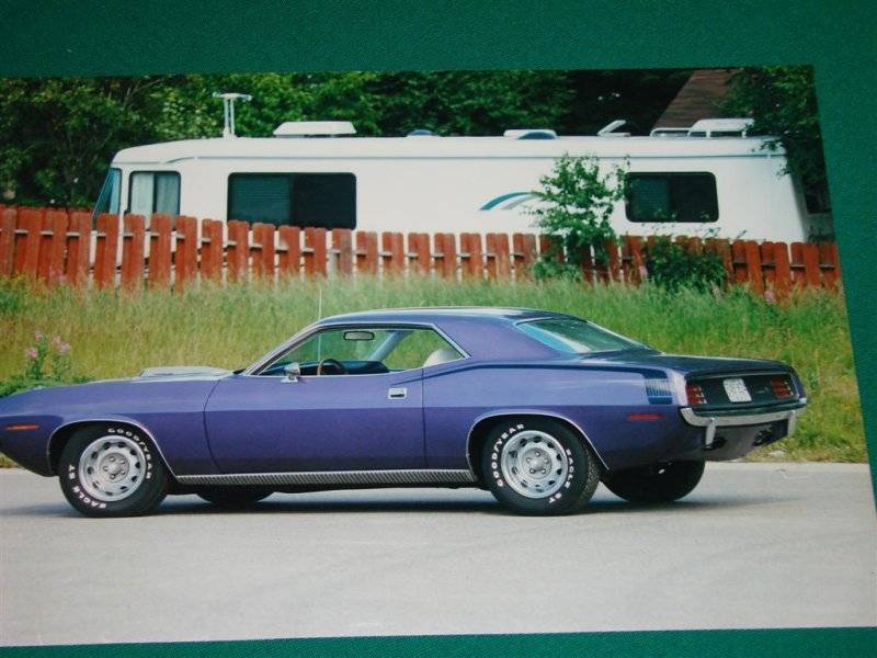

I also love the white, my Barracuda came EV2 with white interior and I kept it that way, not much else was left stock.

White interior: For consideration, white yellows over time and mars and shows stains much more than black. Another reason I prefer dark interiors is that it is less of a distraction when driving.

I am doing disc brakes on my all original 66, using 73 dart spindles and the smaller discs. These work phenomenal on my 66 hemi car that was power 3" drum brakes, but these cars are too valuable to skimp on brakes. A well set up and adjusted set of 11x3 drums will stop really well but fade in todays traffic and curvy roads. White interior would make the car stand out, just use the original seats and recover them. Retain any black parts in good shape in case you change your mind.
I`ll do the discs, I while back I thought there were rotors that used the stock drum spindles and that would save me money, anyone know a source/manufacturer? I love my white interior in my Barracuda and also any color OTHER than black, to me black is boring/plain and it`s all too common. Yes white does yellow a bit over time but really not that bad on a car that is garaged most of the time.

Yes and yes. I loved the FC7/white combo on my Cuda. I think if it had been black I would have changed it to white as well.
