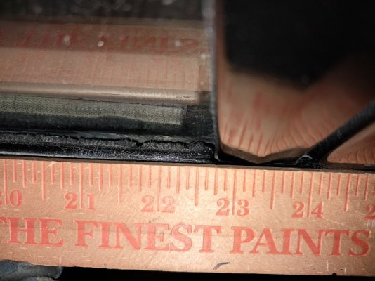

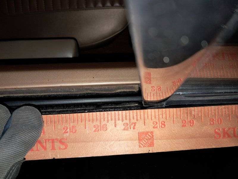

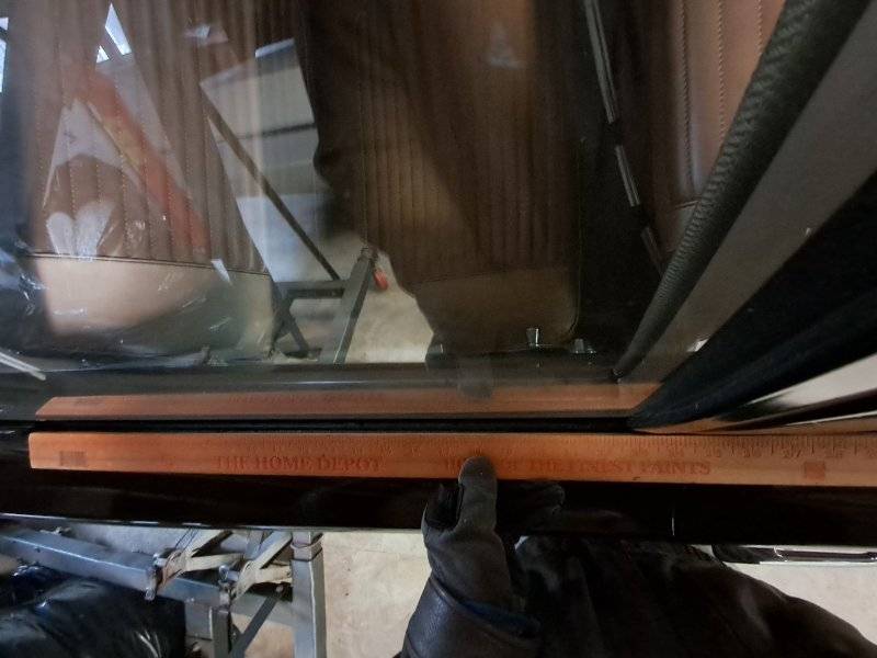

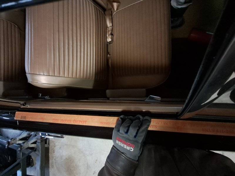

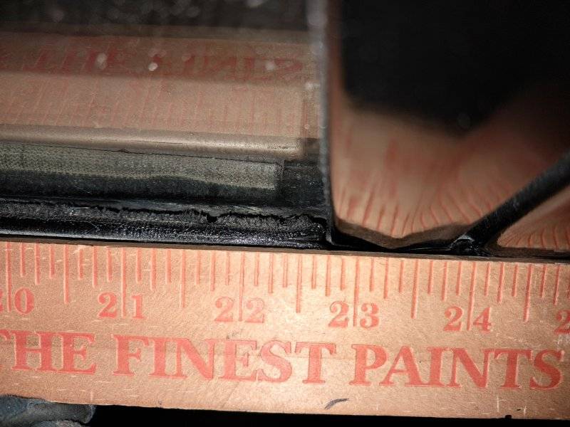

I searched without luck for widow fuzzies/cat whiskers for my 68 Dodge Coronet Station Wagon. They are available for 66 - 67 2dr. Sedans. With a few measurements, I can determine if these will fit my application with some massaging. I am looking for total length for both front and rear side window fuzzies (inner and outer appear to be the same length). If someone has a set that is unistalled, I could used the spacing on the center of the clips as well. Again both front and rear. Thanks in advance.
Hi Fury Man,
66 Coronet 2-door Sedan. Please give me a link for those fuzzies. Thanks
Front Channel Fuzzy 27.5 inches
Rear Channel Fuzzy 22.75 inches
My 66 Coronet 2 Door Sedan (waiting for snow to melt)
