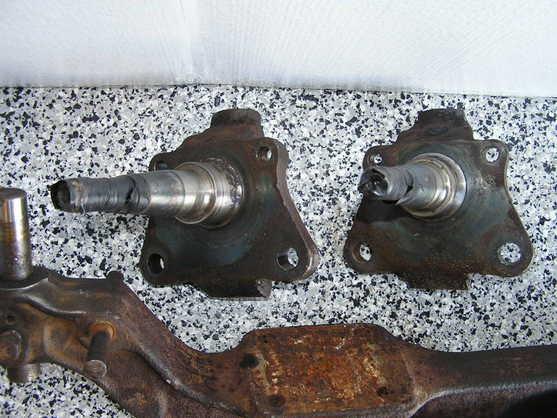

The spindles are OK, but a little worn. The bearings are a tad loose on the spindle shaft, but acceptable. However it turns out 1 hub spun the inner bearing race inside the hub. The inner bearing race now spins freely in the hub!!! crap. Fix: I'm thinking about just Loc-tite GREENing in the race. It will be the last race that hub gets...but it should lock it in place.

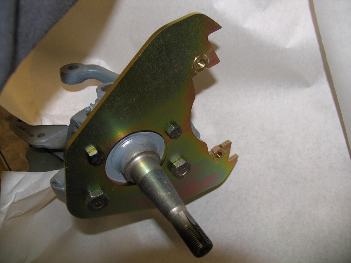

I want to put on some disks. Scarebird makes A100 disk conversion brackets. Cool...I says. I ask for a picture, and it turns out the reg. duty A100 spindles are different than the A100 HD!!! I thought they were all the same. What the hell do I know......

1) Did anyone else know that the A100 had a different HD axle???? 1st pict is my stuff. pict 2 and 3 is the scarebird A100 stuff....
