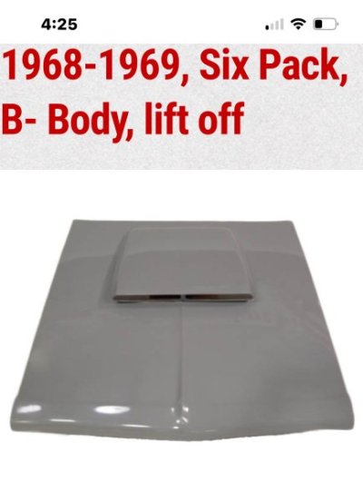

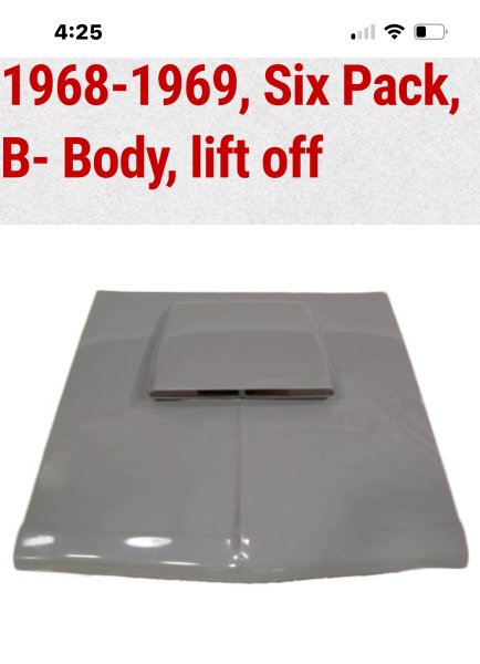

Try
then look under 'Six Pack Hood for a 68 Charger' in the search deal
they have 2 listed,
one pin on $569,
one bolt on style $689
I bought some fiberglass stuff from them a long time ago,
basically a full fiberglass 68 RR body
& all the associated pieces, front end, hood, decklid, doors
for a Blown T/S car I built, in the later 80's early 90's (?)
their quality was very good, 'not sure today'
but they are still in business after some 35+ years ago,
still going strong more stuff then ever
so they must be doing something right
can't vouch for the quality now, been a long time

Yet you showed 'a fiberglass lift off hood', as an example above
for air-cleaners & their assoc. bases for 6-pak or 6bbl
not sure the N96 Super Bee's ones would fit 100% or what style you refer too

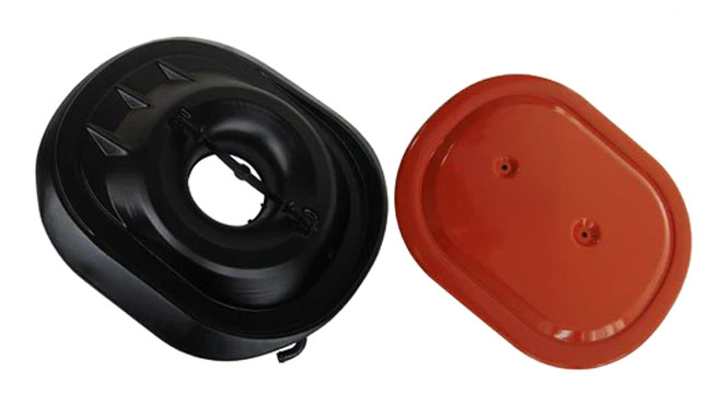

Mancini Racing has some nice restoration type, fresh air & non fresh air
oval air-cleaners, bases & tops, starts at like $489+, goes up from there
probably more now, , 6bbl/six pack air-cleaners & bases
without the elements & they are like $125+,
depending on what style & thickness/tall you want
I use a K&N 3", love it
So does Year One, have resto styles,
but you will pay out the wazoo for shipping
not sure they have the style you're looking for
if the A12 style like a 69.5 will work, flat square-ish design,
to mate up-to/seal an open six-pack fiberglass hood,
like on the 69.5 RR or Super Bee had
you'll need do some measuring,
make sure it will even work, may not have room, maybe to tall
they are about an 1" higher towards the hood, than other styles

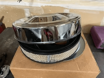

Custom? chrome?, for a 4 bbl with Edelbrock aluminum intake
The six bbl scoop is wide enough that you can use practically any aftermarket aircleaner. If you are running a fairly tall intake ( Eddie intakes for a 440 vary by about three inches, between an old ch4b and a super victor, maybe more) you might need a drop base style.
I honestly don't know what sort of factory air cleaner would work best (concerned about diameter)
A drop base will give up a tiny bit of airflow compared to a flat base. I use the drop base on my car (no hood at all) simply cause it's easier to see over.
You should probably be able to use mostly any style air cleaner. My suggestion would be
Mopar unsilenced air cleaner.
Kinda liking the chrome unit
Mine is a Direct Connection piece that I've had for decades. A nice feature is, you can add a decal to distinguish whatever engine it's on.
