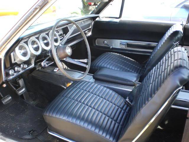

What does everyone know about this convertion. I'm looking to put in an A833 overdriver were the A745 three speed was. My questions are:
Are they the same lengths to were I don't have to modify my transmission cross member or my drivershaft? I know the diameter in the bellhousing is larger on the a833o/d tanny. I've been told that the bolt pattern to the bellhousing is the same. Can I just use the factory 3 speed shifter to shift the four gears and hook up another lever for the reverse. Are the internal speedo gears interchangable? Are the driveshaft splines the same? Does anyone have, or now someone that has an un-abused a833o/d for sale? I need all the help I can get before I get involved in this.

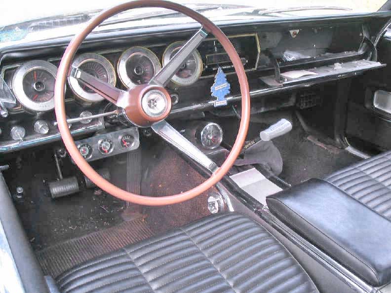

Yeah...I don't think you're gonna get that column shifter to work with a 4 speed. Kinda a shame to get rid of that (presumably) rare "no shifter" "auto" console look. I can honestly say I've never seen that setup before (and I've seen LOTS of 66-67 B Bodies).
I understand all 66-67 small block manual cars were 3 speed on the tree, but I wonder how many 66 chargers were made that way (67 could have come without the console). Can't be many.
Anyone ever seen another? How about a Satellite or Coronet 500 with column manual and console???

I looked at mine, and I dont know how you would get the column shifter to ever work through 4 gears. Also note the shifter levers on the OD trans pointing in the opposite direction of the 4 speed. As you mentioned, the bearing O.D. on the input of the 4 speed overdrive trans is larger, and will need the bellhousing hole opened up a bit. As for the "3 0r 4 speed pattern bellhousing" I doubt your car has this.... Mine didn't and it was original to the car, and all I could find out about the dual pattern was only in truck applications.
I think your only choice here, is to get yourself the 4 speed OD trans with the correct shifter and linkage, Find a used bellhousing and have the hole opened up to fit the larger bearing or buy a new SFI type bellhousing that already fits the newer OD trans, Mount the shifter towards the rear of the trans location, remove the handle from the shifter and mark the location to open up the floorboard of your car, replace the Yoke on your current driveshaft with one of the correct spline for the OD trans, install everything, adjust the throwout bearing linkage and drive. You can install the 4 speed tunnel after all else has been completed.

I think the console is an auto console with a trim "blank" where the selector would be. The rare part would be the blank.
I agree that there is a certain "HUH?!" factor that is appealing, especially in the Mopar crowd.
