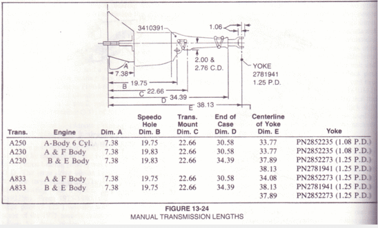

Can anyone tell me how long a B body 833 is? I'm attempting to determine if I need an A body or B body 833 for my current project. I find lots of references online, but nothing with actual dimensions.
The project is a Power Wagon Town Panel, and I'm looking to upgrade from a 3 speed to a 4 speed. I need to make some measurements to make sure the B body 833 wouldn't interfere with my divorced transfer case.

Measuring from the bell housing surface of the trans. I get 14 inches to the center of the B body 3 bolt shifter area and a total of 28.5 inches to the rear edge of the output shaft.

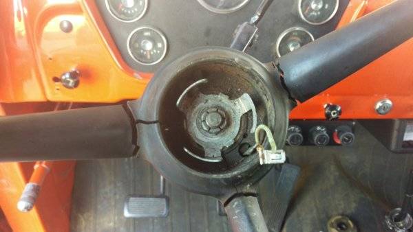

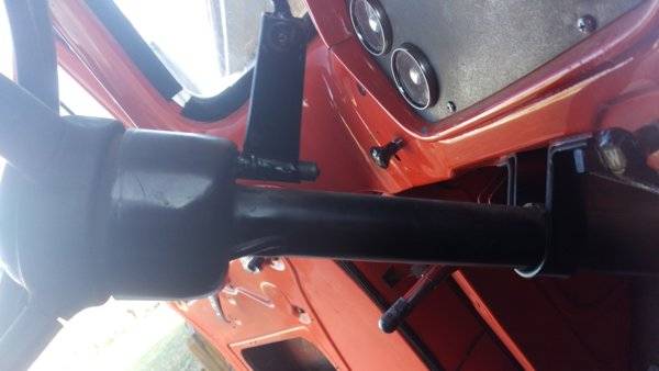

Would anyone happen to know how to remove the 3 speed shifter from this column? Tried a mini pry bar on the pin, but it's not budging. Pliers didn't work, and I don't have a good angle to hit it with a punch. I'm kind of starting to think this wasn't intended to be taken apart...ever.

Well, I finally got it out. That pin doesn't seem to want to ever come out. I ended up drilling holes in the little dimples where they attached the mount inside the steering wheel housing. I cut the shifter handle off the remains of the shift rod, ground away a bunch of ugly old weld where someone fixed this once already, and pulled the remains out through the hole in the back of the steering wheel housing.
Long story short, I don't think these were intended to be removable. On to attempt an np435 swap now.
