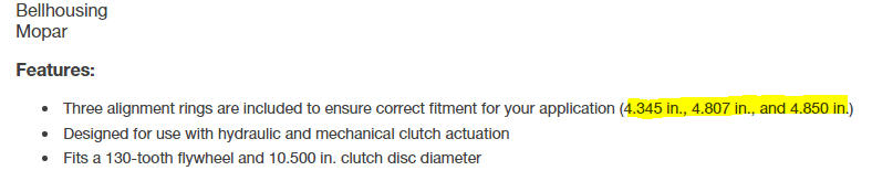

I was looking at this set up, I assume I would have to get a smaller bearing retainer for it to work? I was looking at the 4.345 dimension and the retainer I could get to fit mine would be a 4.354 so I was unsure of that.
Looks like it comes with adapter rings. I don't know if the bore is for the 5.125" retainer. You might call Jegs and ask a Tech.
