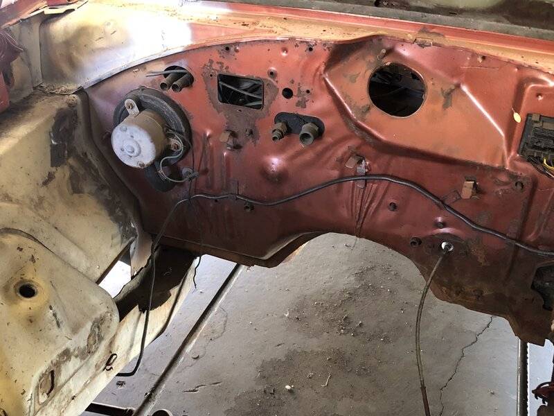

The firewalls are different between the two.
A/C firewall:

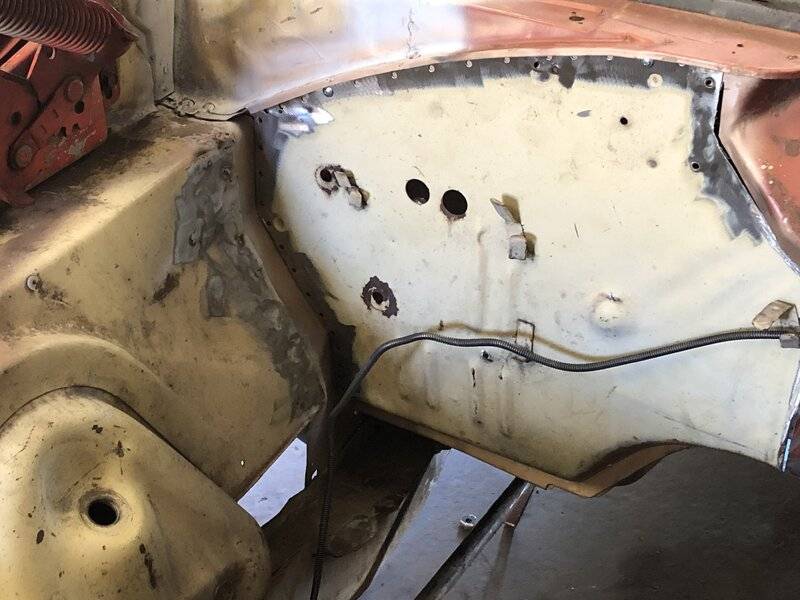

NON A/C firewall:

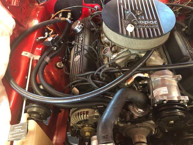

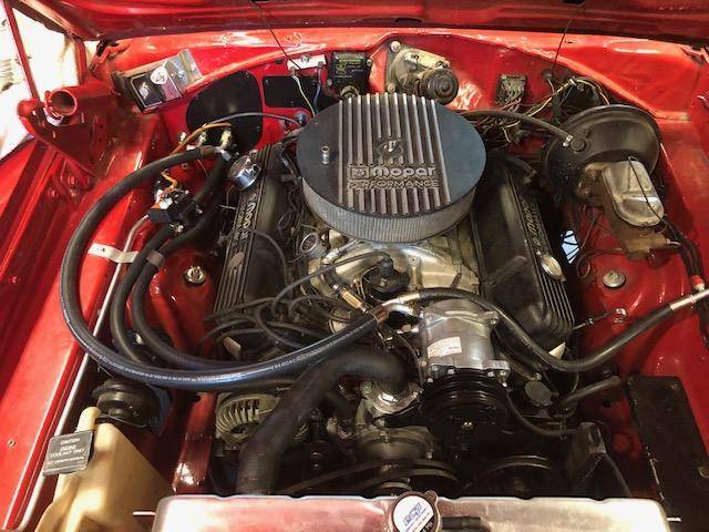

I converted my "Jigsaw" car to heater-defroster only. If I decide to add A/C later, I'll use a Classic Auto Air kit. It allows the engine bay to look less cluttered. THIS is my other '70, a factory A/C car with aftermarket A/C:
The use of a NON A/C firewall results in a cleaner , less cluttered look.
