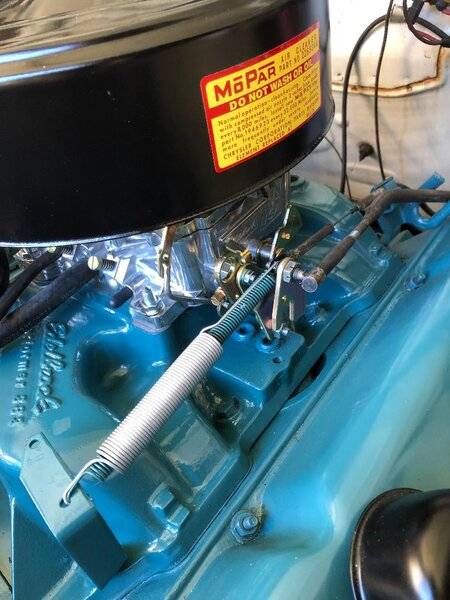

You should have a double spring...

So I had enough light after work today to mess with my engine. The cable seems fine, everything is clamped where it should be and the cable moves freely when disconnected. I only have a single spring on my throttle return so maybe that’s the problem? Or maybe I should just replace the cable to be safe.
