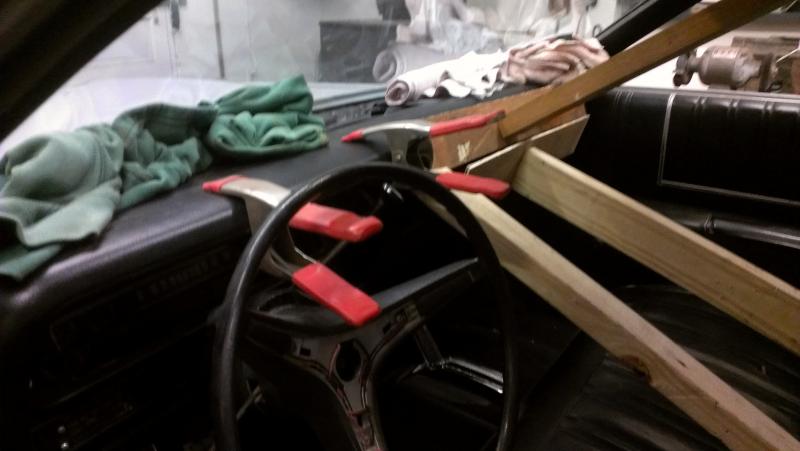

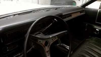

I just took down the high spots so it would lay nice and flat filled in the gaps with caulking, sanded the outside edges down, wiped clean, applied the silicone and gingerly put it in place. If I only had 400 bucks to refinish my front bench now!
love the wood to hold it in place.looks like a redneck rollcage in the makeing!
Something I learned from doing mine is the instructions make a mistake. They state you should only apply adhesive to the front edges of the cap, and not put any adhesive on the rear areas so the cap is mounted so solidly that there's no room for expansion/contraction, which can result in cracking. I followed the directions, and put no adhesive on the rear areas, but once it started getting hot outside, the area between where your clamps are in the picture started bulging up from the rear.
I fixed the problem by waiting for a hot day, then putting some adhesive under the rear of the cap (which wasn't easy to get it past the windshield), then put weights on top of the bulge to keep it flat while the silicone cured.

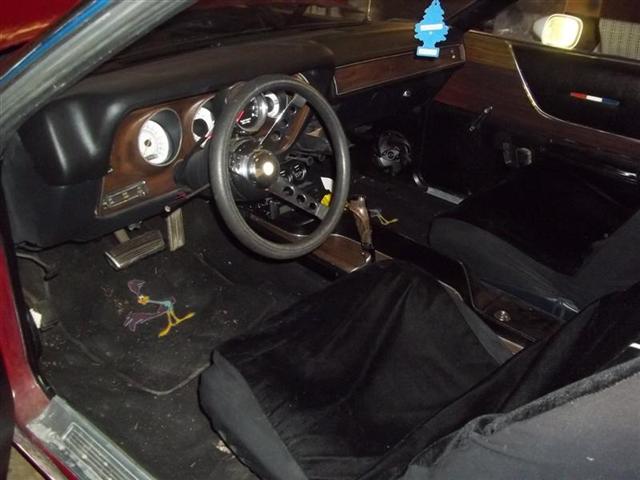

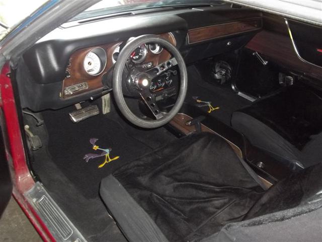

I wont say they cant crack pop up or anything else, i agree if you can afford a pad and its that important to you as these cars are to us then yes, buy a pad. But to be honest, ive never heard of one cracking and im not saying it doesn't happen, it wouldn't surprise me if it did. This first picture is from last summer, some time after i had put it in, the second just recently and still the same, outside of the dust, i could go out now and take a picture, but it looks the same now as when these was taken. For the price difference and what it looks like to me, i would do it again to my next car if they make one for it.
