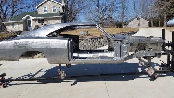

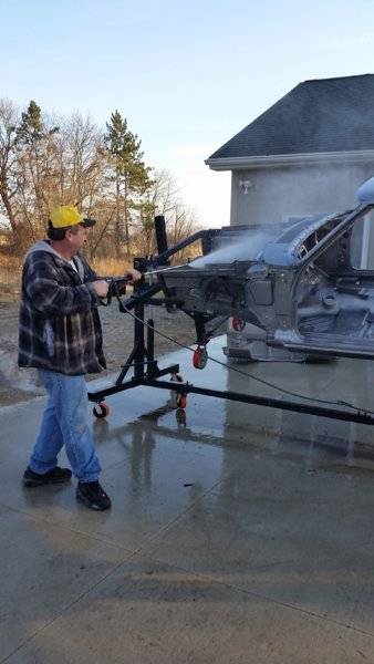

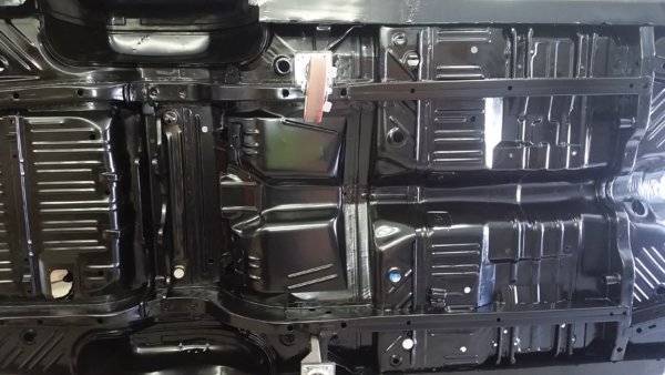

I had mine alkaline dipped (less aggressive than acid) then sprayed with a water based rust inhibitor. Did all my metal work then, rear quarter replacement etc. words of wisdom I pulled a half a five gallon bucket of dried up crap in all the sandwiched metal areas of car, (especially between trunk extensions and rear quarters) spun on rotisserie for weeks debrie kept falling out looked like battery corrosion on the terminals. I went thru every frame rail, rocker etc. with a piece of hanger wire 12 feet long (used for suspended ceilings) with a bend on the end other end connected to a cordless drill, worked great. night before I had it e coated I power washed the car to remove rust inhibitor, spun it on the rotisserie over and over, then took a leaf blower to it and got the water out. the place in Elkhart Indiana, then dipped it in a seven step process to remove the surface rust created by cleaning it with water and prep with i believe nickel phosphate, then dipped. the coating was very durable had some small chunks in the paint, sanded off very hard. they also put some dents in my brand new rear quarters. on the plus side every square inch of the car was coated wherever the liquid could flow. been on for two years, no problems, unlikely car will ever rust. I have heard stories of guys getting there car stripped and then dipped in a couple days, and not getting all the crap out, it burns holes in the areas where the stuff is still there sealed in the e coat, then burning holes thru the metal, ruining there car, also lead seams to boil out in this process too, i did my sail panel area with lead it blew it out, even flowed a little of the original lead surrounding the window pillars. good luck, and yes i would do it again, not many people have a car that's sealed up this well.

the advantage to having the car chemically dipped is, when I replaced the rear quarters on the car, I pealed apart the rear steel, and at all pinch welds there was no rust, pretty much clean metal, Probably the best result I have ever seen, so all rust is gone. the alkaline was netraulized when it went to Indiana for the electrocoat dip, which the car went thru another acid dip this time with a nickel phosphate treatment. currently the car is at Richard Petty's garage where it received an engine upgrade and will be going on a nationwide car show tour. The car has been named "The White Ghost". It is the last car to go thru Petty's garage, The owner just called me tonight with the update. The car will be shown with a demon 170 and a 1970 Super bird (green) and another matching green demon 170. The car has been signed by Richard himself and "is" the last car going thru Petty's garage. So if you can have the car dipped do it, but make sure it is cleaned with water and re dipped. And the best part is there will be no sand abrasive falling out of the car forever.
