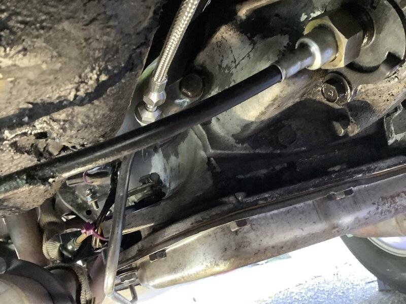

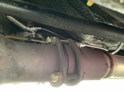

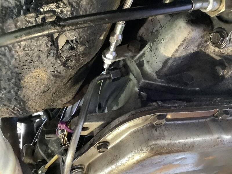

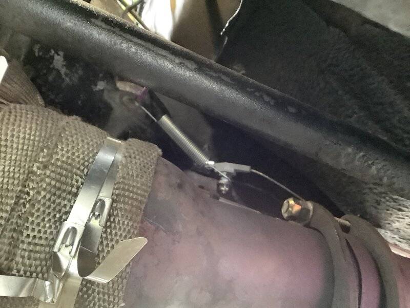

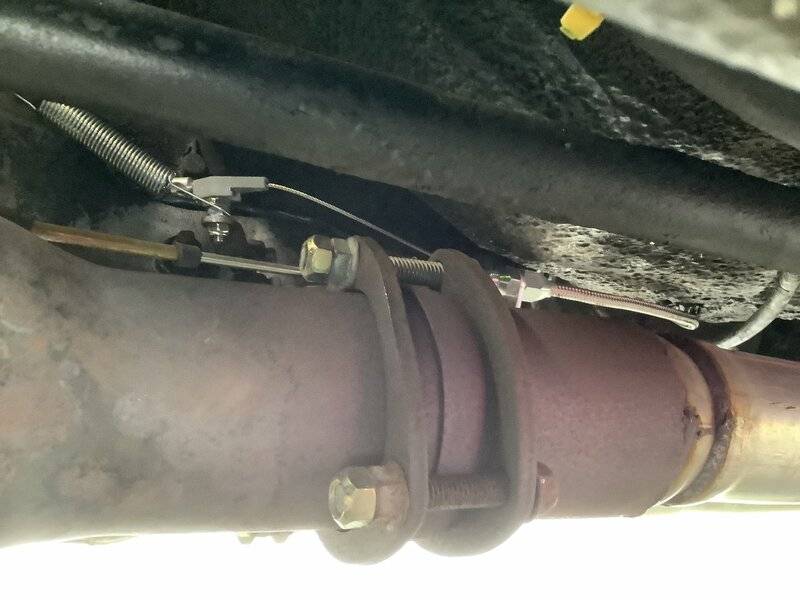

I had a similar problem when I put lokar cables on my Charger and the simple thing that seems to work is putting a mild spring on the transmission lever that goes forward towards the bell housing to keep light tension on that lever. The cable pulls from the rear and the rod linkage was pushing from the front and also had a similar return spring on the throttle to make sure that transmission lever follows the throttle pressure and returns properly to control the shifting. Hope this helps you.
:luvplace: … Pictures are not very good but I wasn’t thinking about documenting so much as getting the cable working properly. :xscuseless:
3794FD08-D3C7-43DB-BCC7-94D5A023B2A2.jpeg B1D0DCB1-CD77-43F2-8D63-9408E22B46C4.jpeg 215F8F7F-92D7-41F1-AFF4-24CDD00111D0.jpeg 12E5FC7E-CD93-49D6-BE1D-4808B3BC42F4.jpeg
