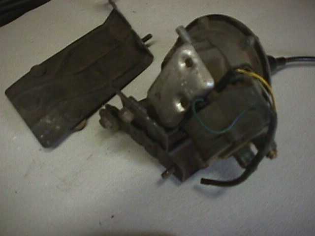

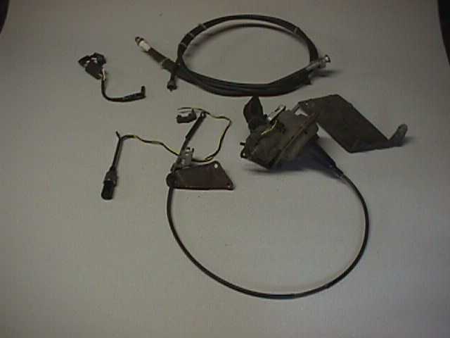

I have a factory cruise-control system that needs a good home.....e-mail me MVC-099S.JPGMVC-098S.JPG

That looks like an early control lever on that unit for sale.
Is it all inclusive? What's the asking price?
I've got 73/74 setups from two different parts cars, plus whatever interchanges from a 5th Ave, but I'm still not sure if I have everything for one complete system. All the parts are scattered in several different locations... I missed an op to get a complete system off a 77 360 club cab, and it was CHEAP ($15). I was too lazy that day.

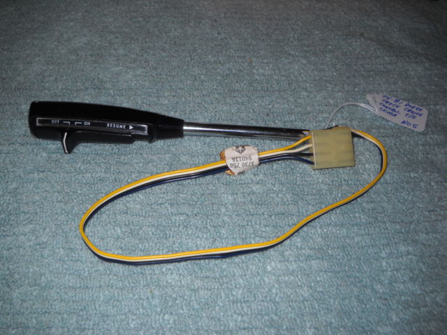

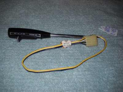

The factory 71-74 CC/turn signal stalk IIRC, is a direct bolt in, and conceals the wires in the hollow stalk-
