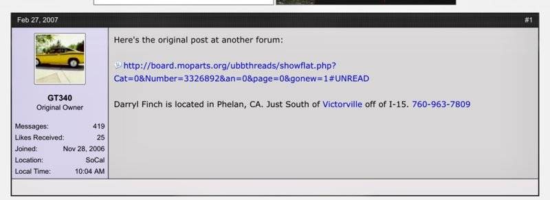

That is a tall order. I bought almost mint vents from this vendor at Spring Fling. Not new, not cheap, and not green. But he really has a horde of difficult to find parts. Darryl Finch.

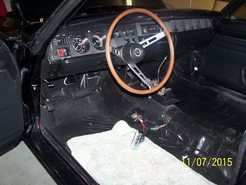

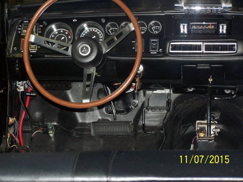

Could you post me a pic of your dash if you have one? I know the center vents under the radio would use this center pad... but what do the outer AC vents look like? Are they IN the dash, or UNDER the dash?
They are IN the dash. Cutting required. If you find some, remember that the 69's are heavier and the 70's (that look identical) are plastic and very light. My application is for a Coronet.
They are the two lower ones in your picture. They go in the lower corners on both sides.

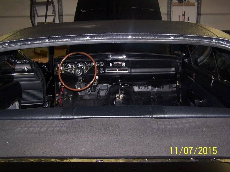

Here are a couple pics of my 68 Charger. Like I said, I sent the dash pads to Just Dashes for restore but they don't put the stitching back in and they don't fit like factory ones did. You can see that when you look at the center spot cooler.

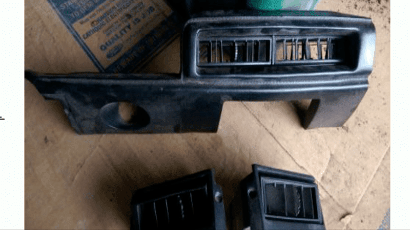

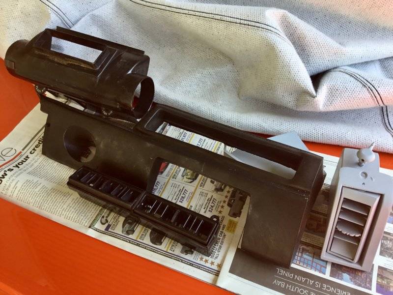

Got these 5 pieces for $400. When dash is redone, I will eliminate the under dash-vents supplied by Classic Auto Air.
The top left piece with "floor air" label worth messing with to get function?
View attachment 605056 View attachment 605057 View attachment 605058

View attachment 605074 Got these 5 pieces for $400. When dash is redone, I will eliminate the under dash-vents supplied by Classic Auto Air.
Our dash is green, so this wouldn’t match. Was hoping for a quick solution but this sounds way more involved than I though to keep it “original” looking.
