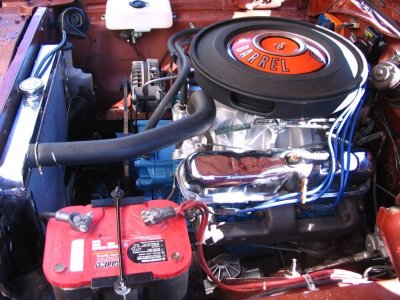

Does your radiator have a built in expansion tank on top like mine does? If so, there is no need for a recovery tank. If you DO need it, either you have an overheating problem or you are filling your radiator too full.
This picture should give you an idea of what I am talking about. The tank is probably only half full. The head space is for expansion.
View attachment 403326 Does your radiator have a built in expansion tank on top like mine does? If so, there is no need for a recovery tank. If you DO need it, either you have an overheating problem or you are filling your radiator too full.

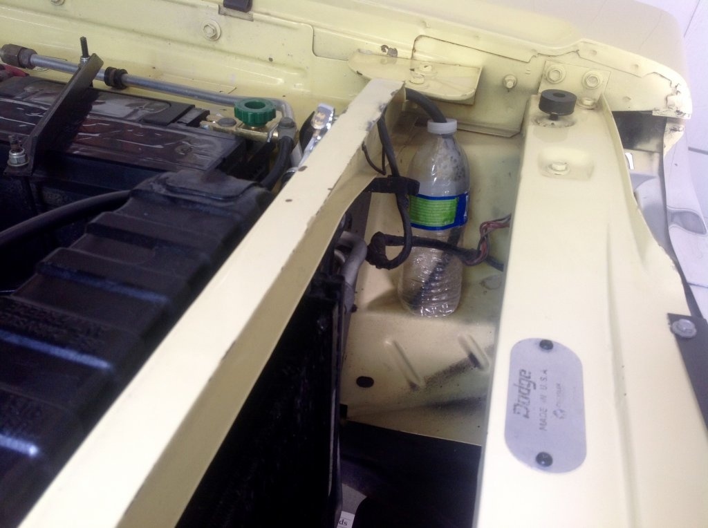

I've got a glass Dr'Pepper Bottle as an overflow 'recovery system' Look great! :)

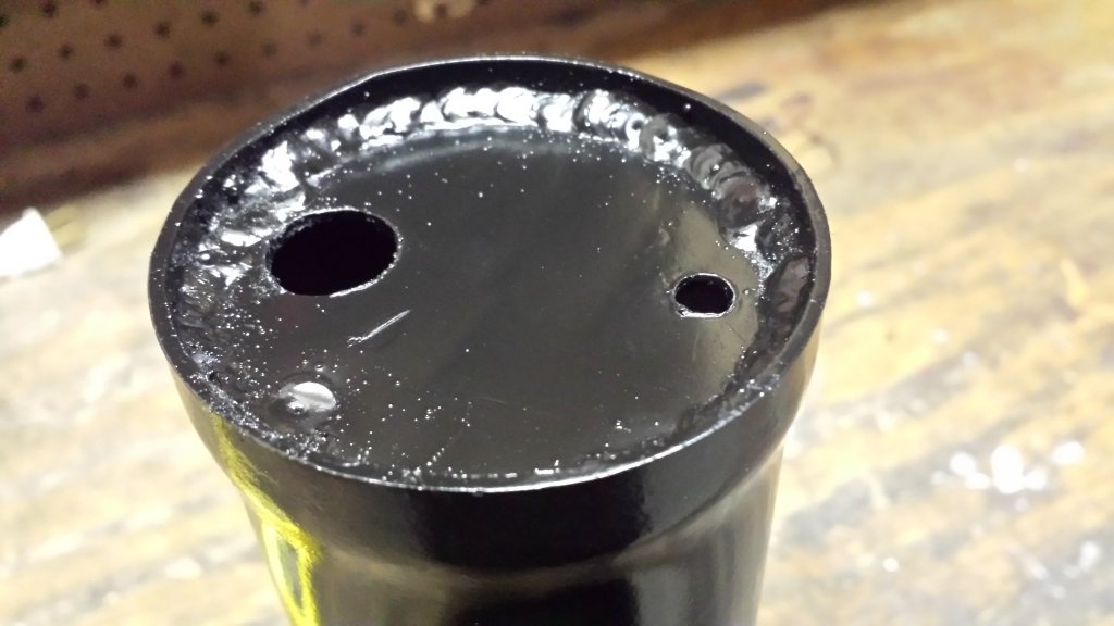

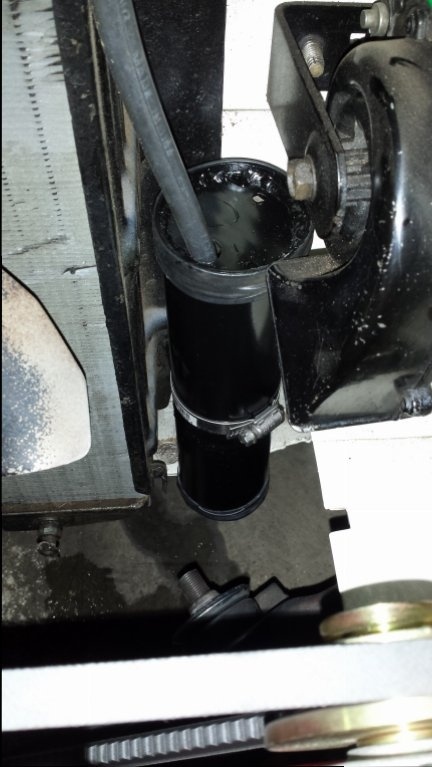

My 62 never had a overflow tank and I got tired of seeing puddles after shutoff so I made one. Tight space so I used a piecs of 2 1/2" exhaust pipe with the ends welded, holes on top for vent and overflow tube. Works fantastic, no more puddles and no topping off!

View attachment 405113 View attachment 405114
I'm liking it!
I want one on mine too. The radiator I bought has the nipple on the neck pointing towards the drivers side. Might have to mount it on the outer part of the radiator support.
Nice job on the tank:thumbsup:
Topping off is the reason you have puddles. If you over fill it, it will puke out the excess and seek it's own level. After that it should never overflow again.
