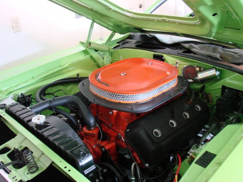

I have a custom made 26" aluminum radiator with dual electric fans to look like a Mopar radiator. This particular car makes more than double the horsepower my other cars do and it runs cooler than all of them. I have never seen about 171 degrees even on 95+ degree days. (On the digital Racepak dash screen).

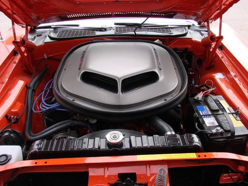

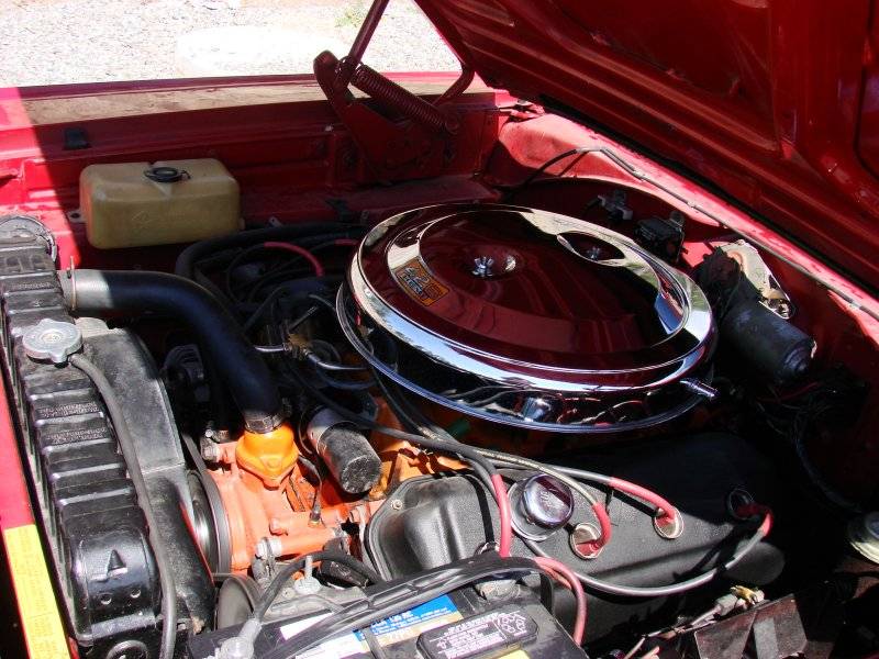

I always run 190 thermostats to warm the engines up faster and reduce wear. Stock 22 inch cooled my 426 well for years. I used stock 26 inch rads for my 472's and 528's. Stock shrouds and stock fans and fan drives, no problems. I live where it's around 100f in the summer.
