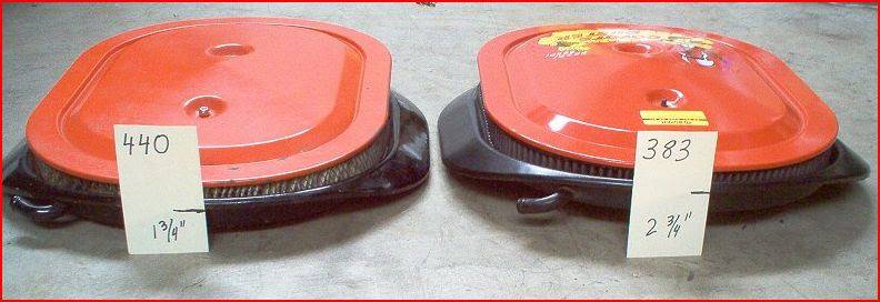

I think you want to measure from the air horn to where the base of the filter rests, as the filter and lid are the same on each. In that picture the 440 one may be resting on the edge and not the air horn, not sure, but if you have both you’re good to go!
Good point. I shouldn't always rely on a picture I found online! I will try and get some measurements this weekend to verify.
OK, so it was gonna bug the heck outa me if I didn't go out and measure. I measured from where the base sits on the carb to where the air filter sits on the base. You were correct. It's 3/4" difference. Not sure how that guy got 1" on his picture.
So at least now I know the actual difference between the two :thumbsup:
